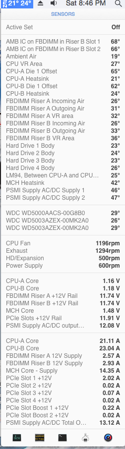

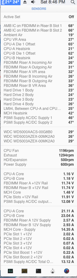

I finished the upgrade a few hours ago using Arctic MX-4. These temps seem kind of high, what do you guys think?
Running X5365 SLAED cpu's. After cleaning the heatsink and cpu I tinted them both thermal compound then applied a thin horizontal line across the cores before seating the heatsink. Hopefully the temps will drop in a few days
EDIT- under a stress test the die temps drop to around 40 degrees celsius. Why would that be happening? SMCfancontrol is set at 1200rpm, the fans didn't get louder during the geek bench stress test

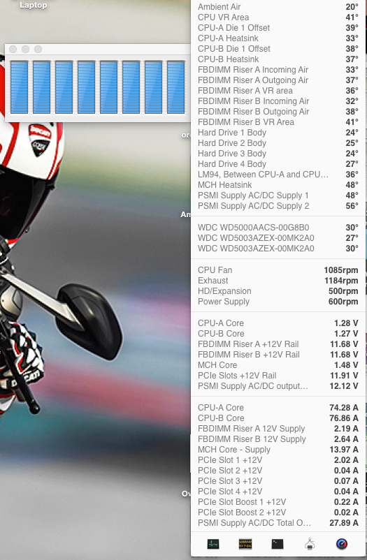

This is with the cpu's pegged

Looks like istat doesn't work right with these mac pros. To get the real temp you must subtract what its reporting from the max cpu temp (100C). So I'm idling at 35C and full load is 60C. Sounds a lot more reasonable. Temperature monitor doesn't report cpu temp at all on this mac running OS X 10.10
