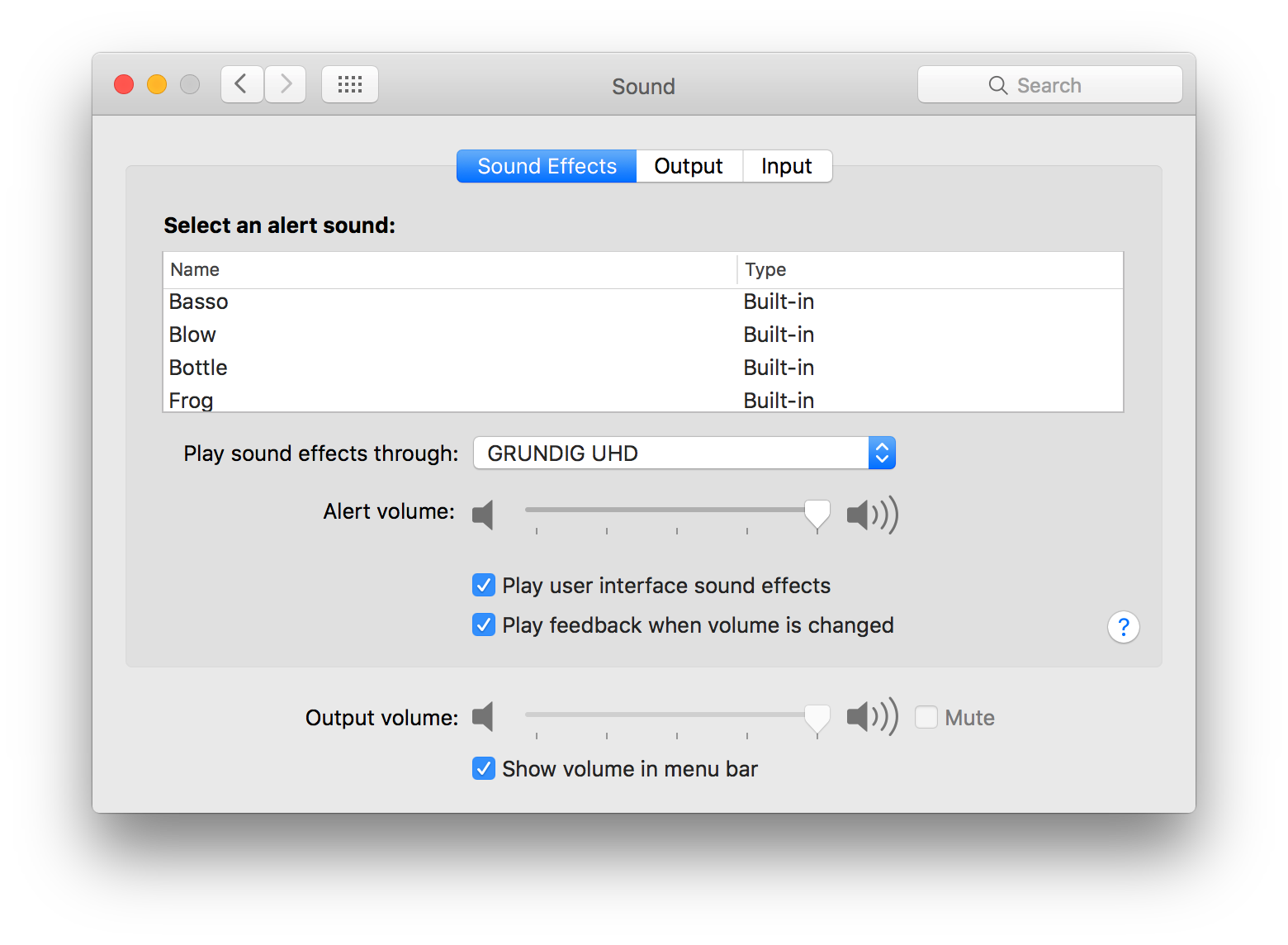

[doublepost=1544196025][/doublepost]This is how it looks after you installed it successfully.
For me SIP needs to stay disabled.

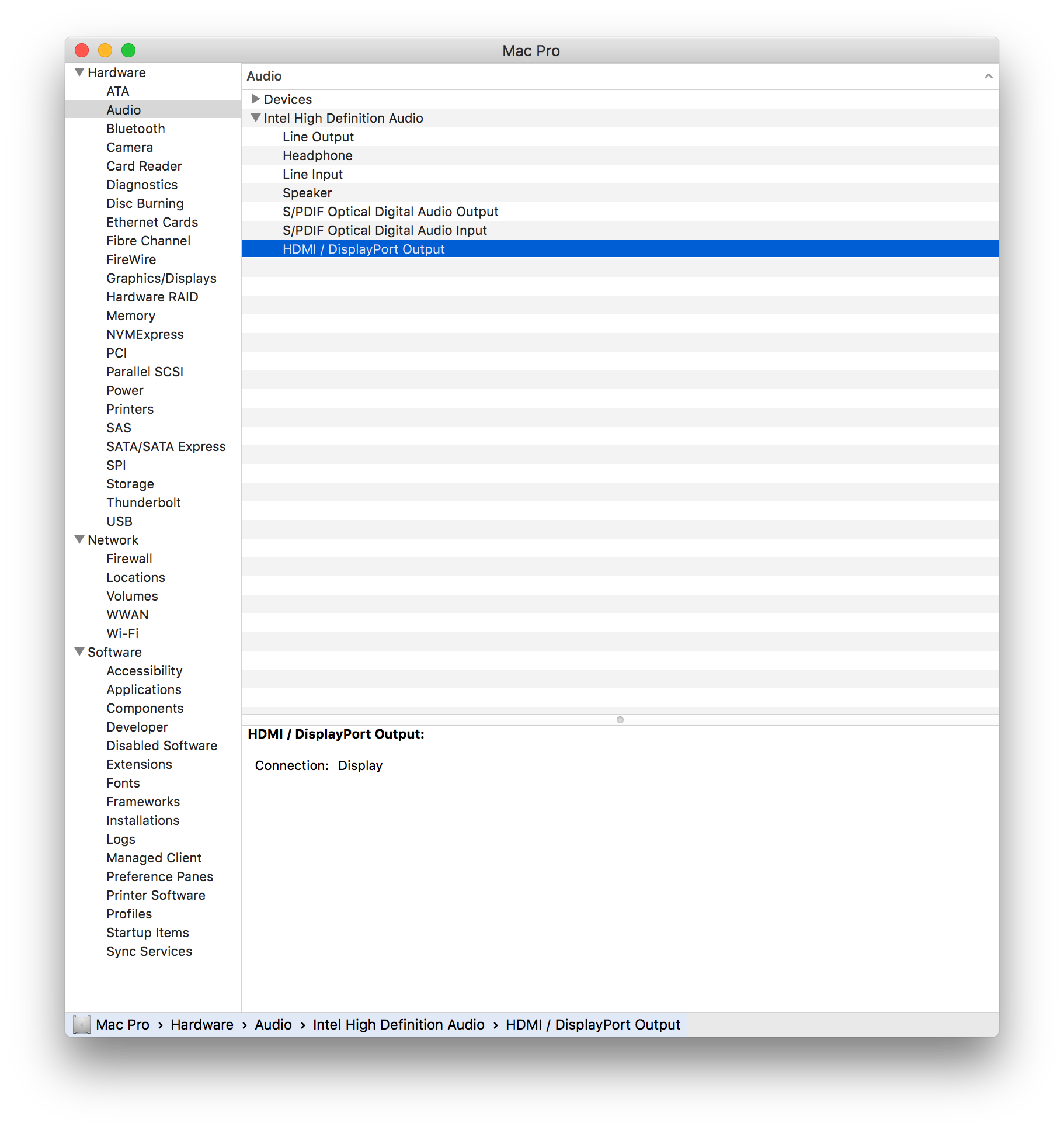

Check Utilities, Audio MIDI Setup if DisplayPort is shown as an audio device.
Also I’m pretty certain that the 5770 doesn’t provide audio over DVI. But I might be wrong here..
Okay, I reinstalled OS and I did the HDMIAudio install and rebooted twice. When I go to Audio MIDI Setup, I don't have DisplayPort as an audio device...

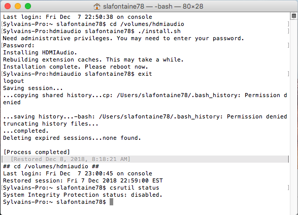

Open terminal and please check if SIP is disabled (csrutil status)
I'm connected to mDP with an adapter to convert to standard HDMI cable. Then I go to the television thru my samsung 5.1 blu-ray amplifier. I also have windows installed on a separate HDD and the sound works perfectly so I know it's not a hardware problem

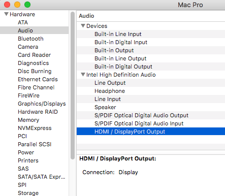

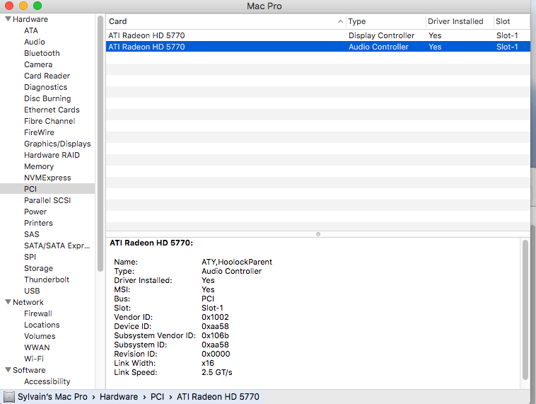

SIP status is disabled, if you look at the file you can see it. I also included the system report:
