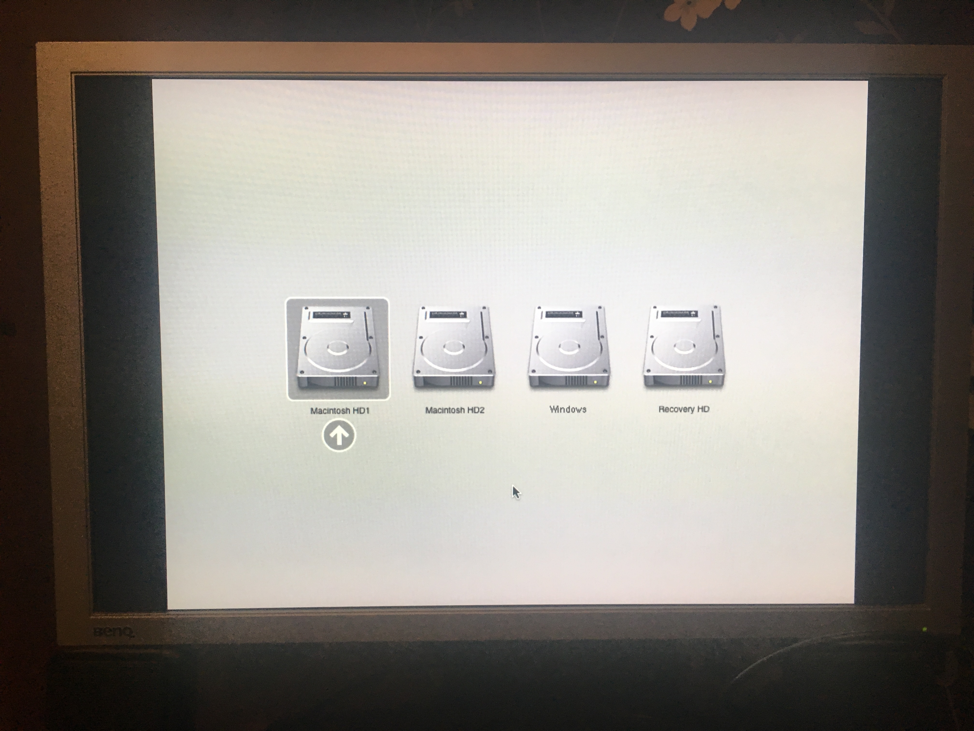

I was using my Mac,I put it to sleep and then a few hours later when i woke it up again I was presented with a blank screen ,the monitor isn’t picking up a signal.
When i hold the option key down on start up to get the boot loader screen up the image appears to be low resolution ,when i then click on a hdd to boot it takes longer than usual to boot then goes to a blank screen again,it does seem to be working as it seems to boot up there’s just no video,only on the bootloader screen
Here’s what I’ve tried so far :
-Pulled out the trays of ram
-bought a replacement graphics card
-tried the graphics card in pci slot 2
-pulled individual hdd’s out
-unplugged usb keyboard/mouse
-replaced the little cr2032 battery
Any ideas ?

What’s puzzling me is why i can only get the boot loading screen but in a low resolution.

2 you posted a screenshot of your display, do you actually see the boot select screen?

2.yes it actually displays on my monitor.

7.the bong,and all fans spinning,then hdd spinning I get A white screen with the Apple logo (in low res) and a spinning wheel for about 2 minutes (which is not normal) then i get a blank screen but the hdd is still making the usual noises as if it’s booting into the OS.
