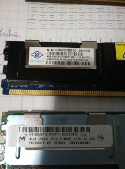

I have bought some compatible 4GB RAM modules, actually 2 x4 dimm packs of different brands, and I'm totally unable to get the machine to boot properly with those installed. I have tried them alone, combined with some of the RAM the machine came with with no success. For information, the machine came with 4x512MB Kingston modules and 4x512MB Hynix module.

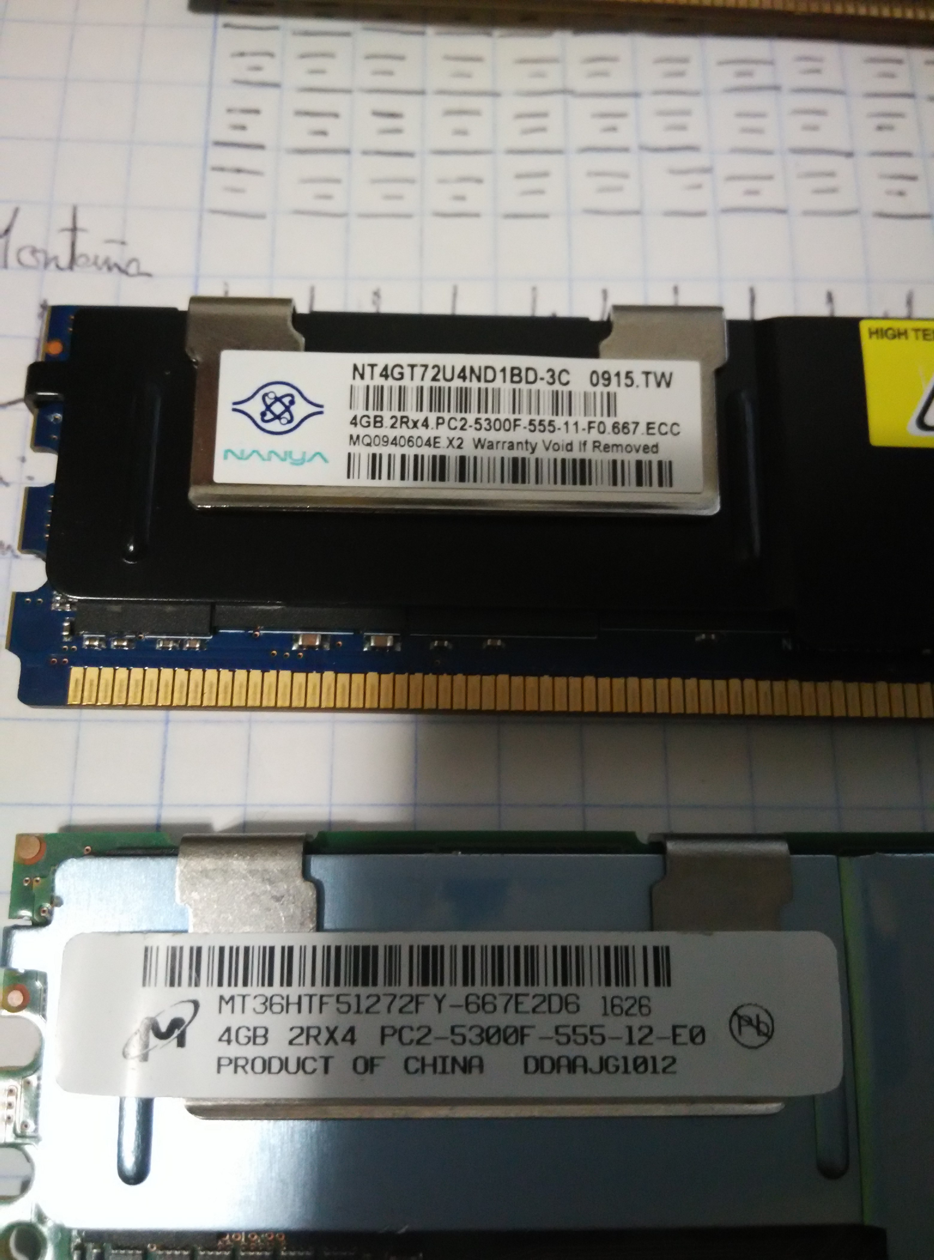

There are the new modules I tried. I have four of each model.

These look correct to me. I suppose one or more sticks might be bad.

I've tried every using just a pair of modules of the same model in every single possible combination, so that will mean 75% of bad dimms. Not impossible but I don't think it is the cause.

emm the top ram is EEC is the bottom stick ECC?

I have tried every single valid combination without any success. So it have to be something pretty exoteric, like very first batchs machines not accepting dimms of that size or something like that.
PS: Oh! I totally forgot to mention I upgraded the CPUs to X5355 and installed the 2.1 firmware patch to get the cpus properly recognized.
