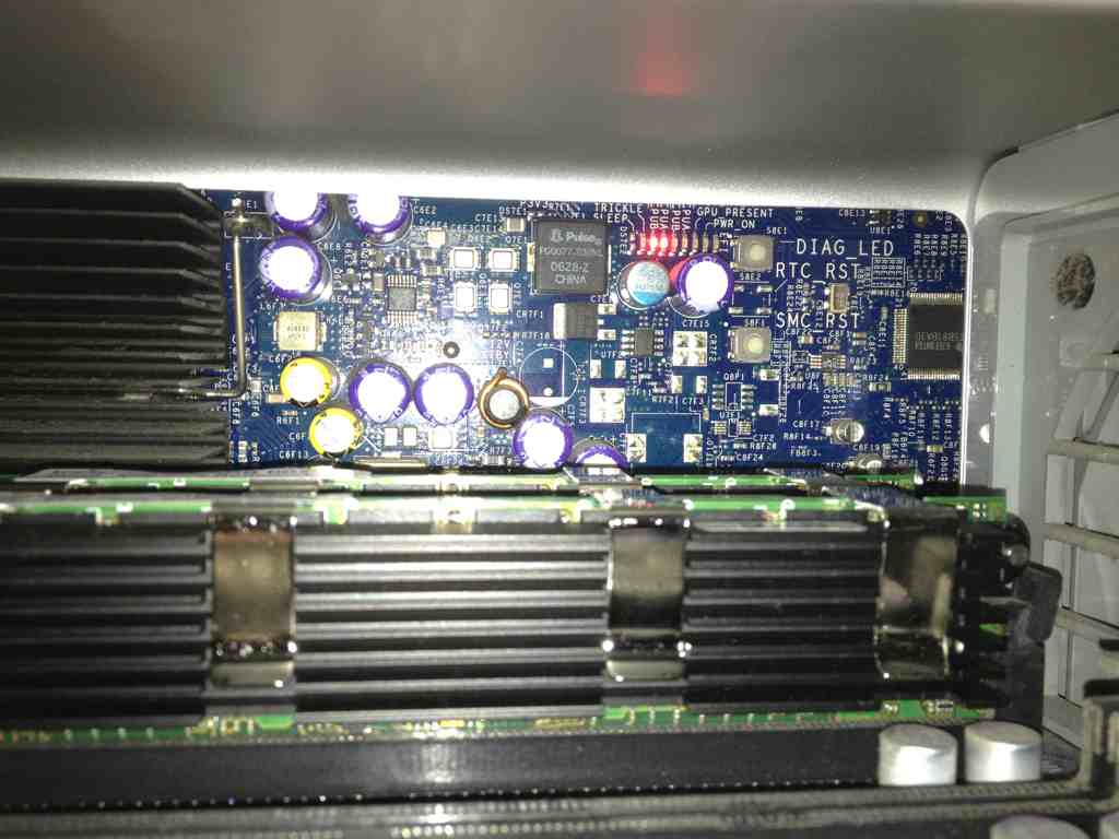

Next time your Mac Pro freezes, do not shut it down. Instead, open the side panel and look at Diagnostic LEDs on the logic board (above the memory riser card A).
If any LEDs are lit in red, the logic board might be broken, which happened me when my Mac Pro had almost the same configuration as yours. I wasn't able to try the firmware update because it was before the update was available.
I sent my Mac pro to Apple for the repair and they replaced the logic board.
The new logic board came with D firmware, so it might solve the problem or the logic board was really broken.
it's worth the try updating the firmware before you think something is broken.

Did the firmware update and it seemed to be running smoother. Played in FCP X and Motion5 for a few hours last night and it seemed great. Played with both programs again this evening and all was fine. Then was using just Motion5 and it just rebooted on me, didn't freeze on screen at all, monitor read "no input signal" and the next thing I knew it was rebooting by itself. Played in only motion5 for a whole again, locked up. Then it locked up and I popped the side cover off to reveal this. Rebooted, used FCPX and motion5 some more, did some heavy renders in FCP as well...activity monitor showed only about 22 percent of the CPUS still idle while rendering, regardless it ate it up and I had no problems for the rest of the evening.
My options now are?

ATI x1900 GPU
IMO this is the source of your problems. CPU LEDs could be misleading a little, but if you'll read Service manual carefully, you'll notice that one (or both) of them could also point to PCIe card failure. If you'll add screen lockups to this and bad fame of X1900s - you have an answer.
Enable screen sharing, remove X1900 and stress your computer with something remotely, using another Mac.

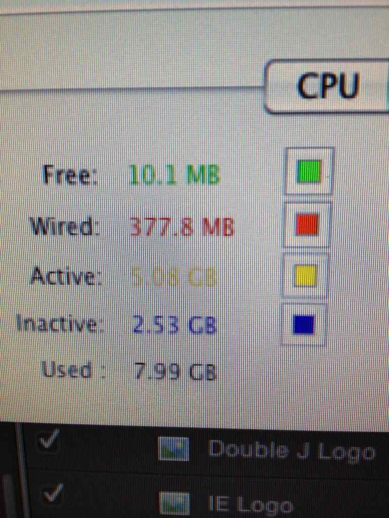

I have been editing in FCPX and Motion 5 for a few hours straight this past week. Haven't had any sort of lockup issues (FCPx crashed once but it opened right back up and there was no issues from there on). CS5 photoshop runs awesome as well now too, even with motion 5 open jumping back and forth. ONLY, issue I had was rendering a semi long title I was making in motion 5. It ate the 8gb of ram I had in the machine, I just got another 8gb today and I can't wait to go home and see what it does now.
Got 16gb of ram in there now. But it only shows in About this Mac and Geekench. Activity monitor only sees 8.
