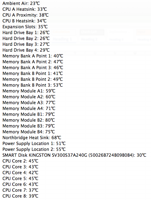

Here's a screen shot from a second ago of my 1,1 at work-it has been idle for a few hours, and I woke it up specifically to show the RAM temps.
These are all 2gb Kingston sticks with Mac Pro heat sinks. Your temperatures are very much what I'd consider normal for a 1,1, but it also is why I prefer to only use memory with the proper heat sinks.
