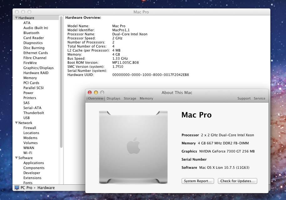

The 5355 processors are 2.6ghz quad core aren't they? not like the dual core that's currently installed? Or are the 5355 processors 2.6ghz dual core and x2 to make it quad core? Sorry if that sounds stupid, not really sure about how the processor side of things works.
This is it...
Ahh 2ghz, you may find that single threaded tasks may be a tad slower compared to the C2D. For multi threaded apps the xeon should* best the C2D.
