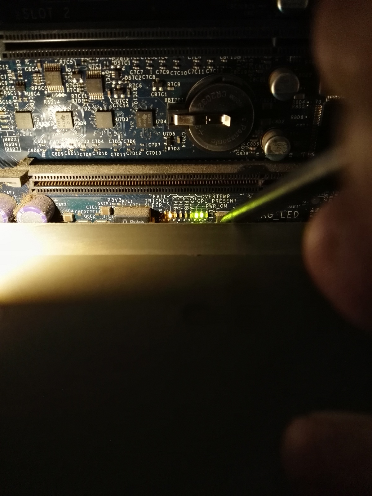

Trying to decifer wich part of my old mac pro 1.1 is at fault. (2x2.66/GT7300/SSD/20GB) for not being able to load any OS
Have pushed the DIAG'nose button on the pcb, and got the following LED-feedback, where the four LEDs in CPU A&B not turn on). (attached picture)
Can i take that "info" as a valid-indication that its the CPU at fault?

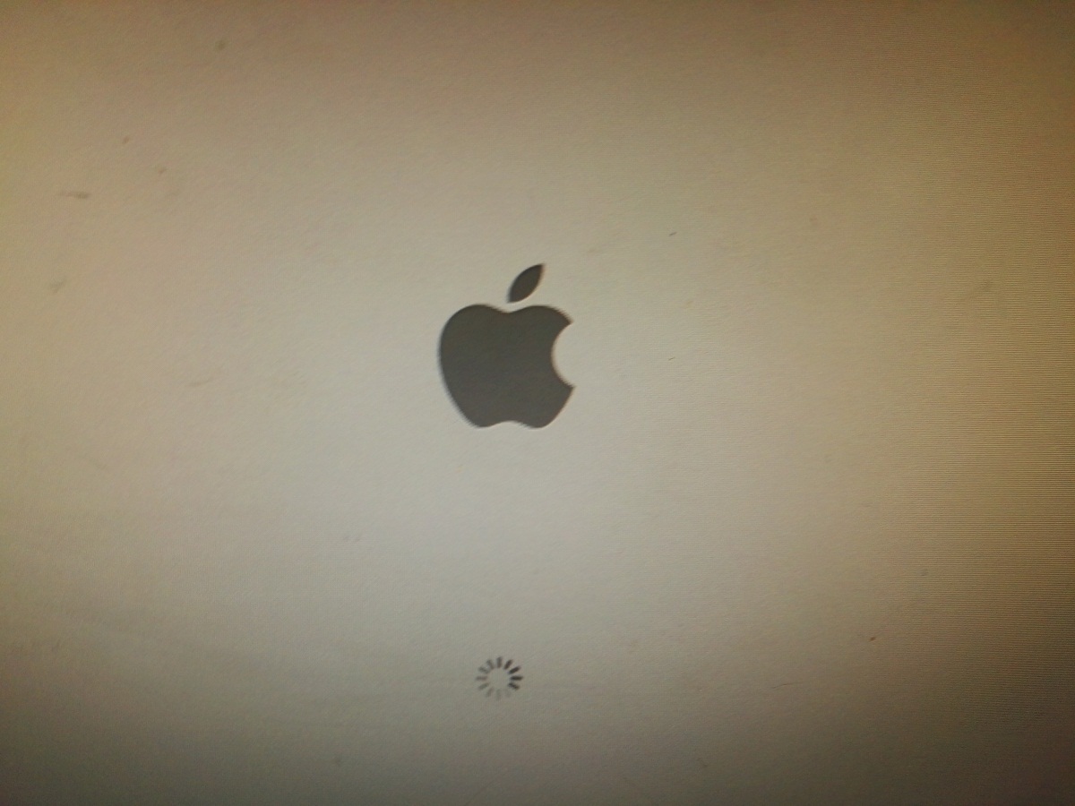

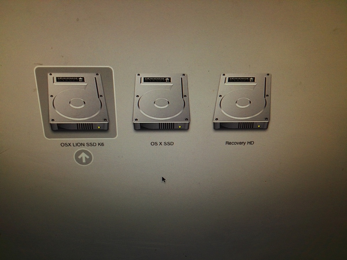

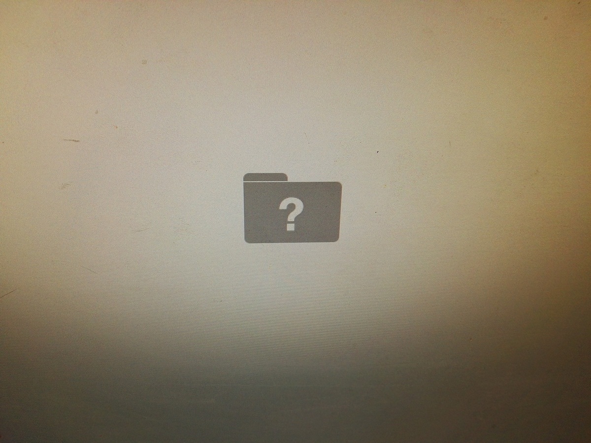

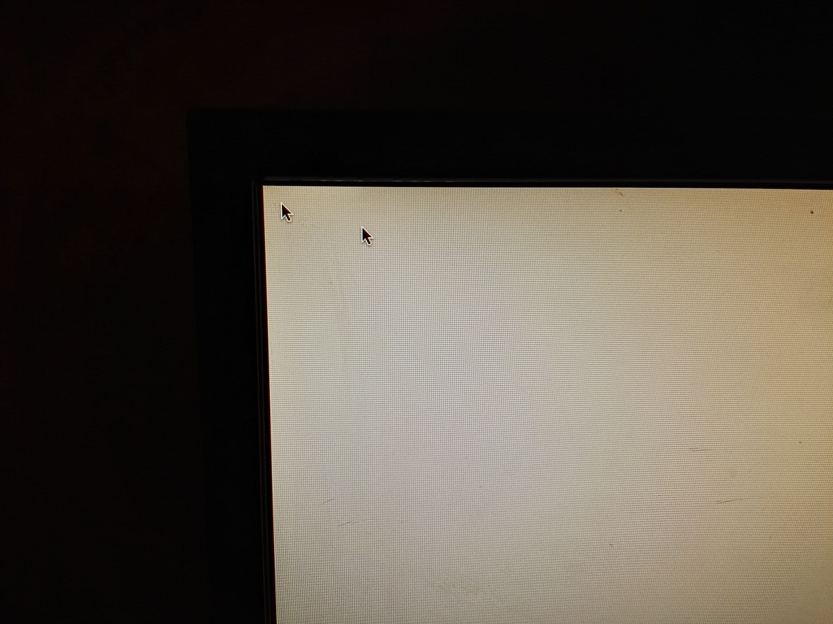

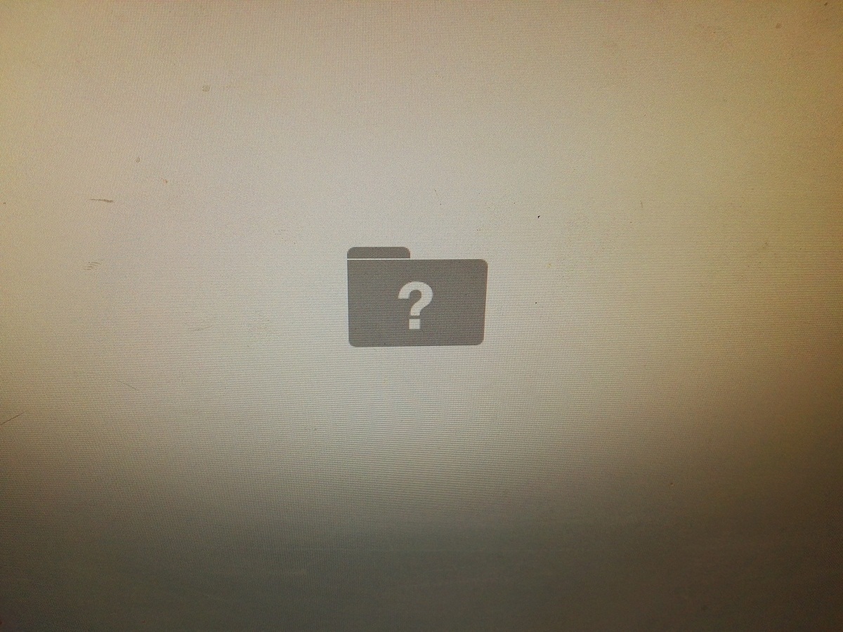

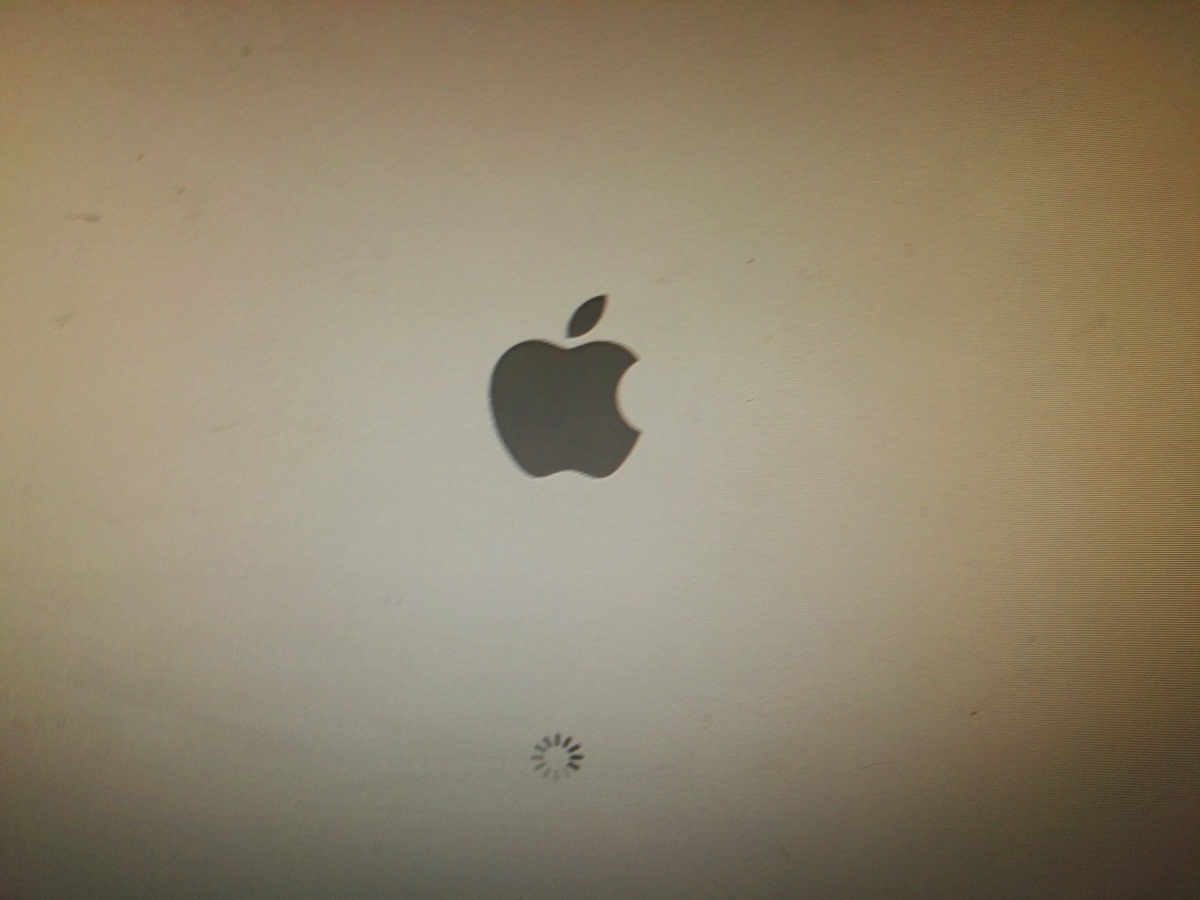

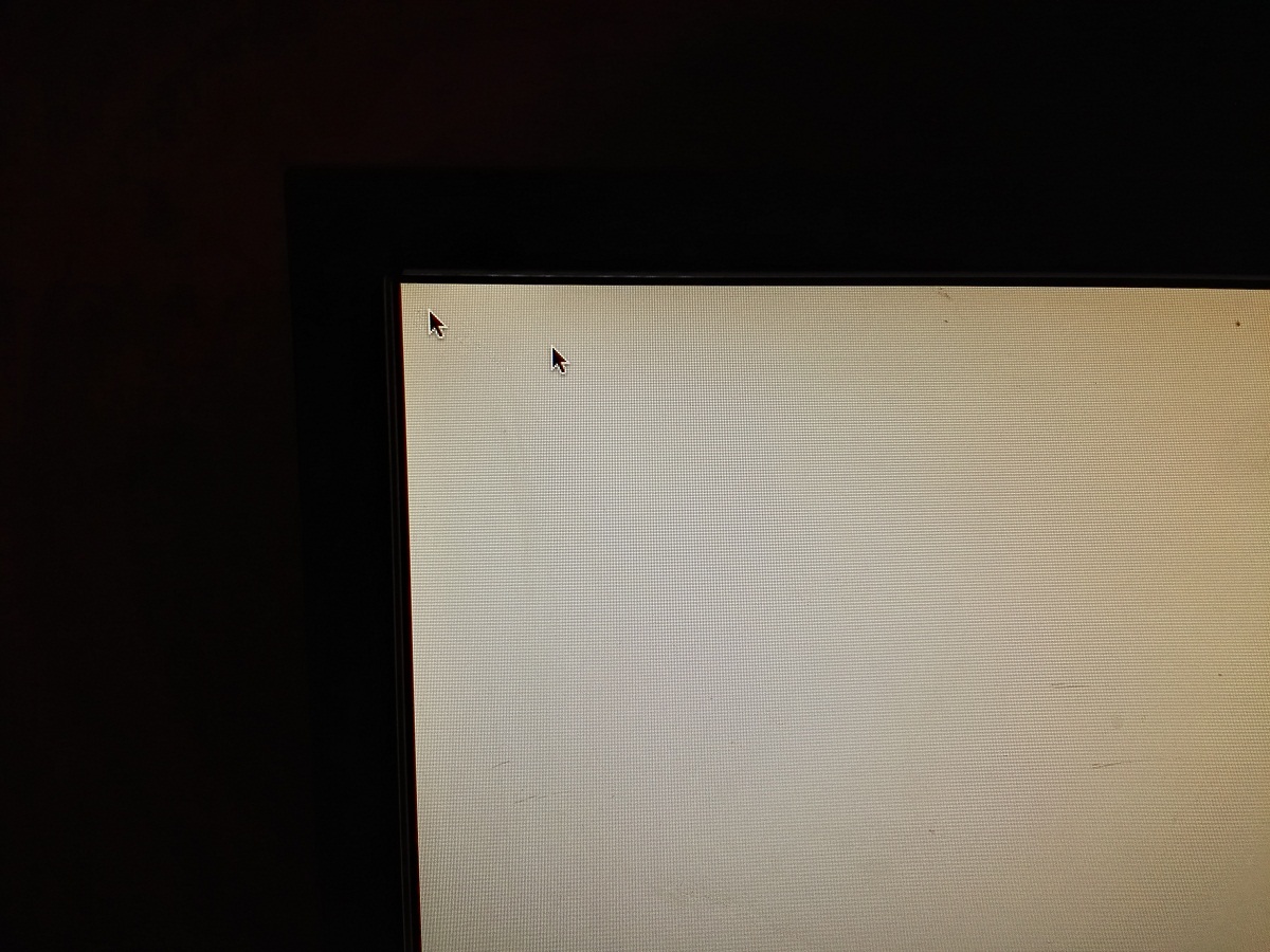

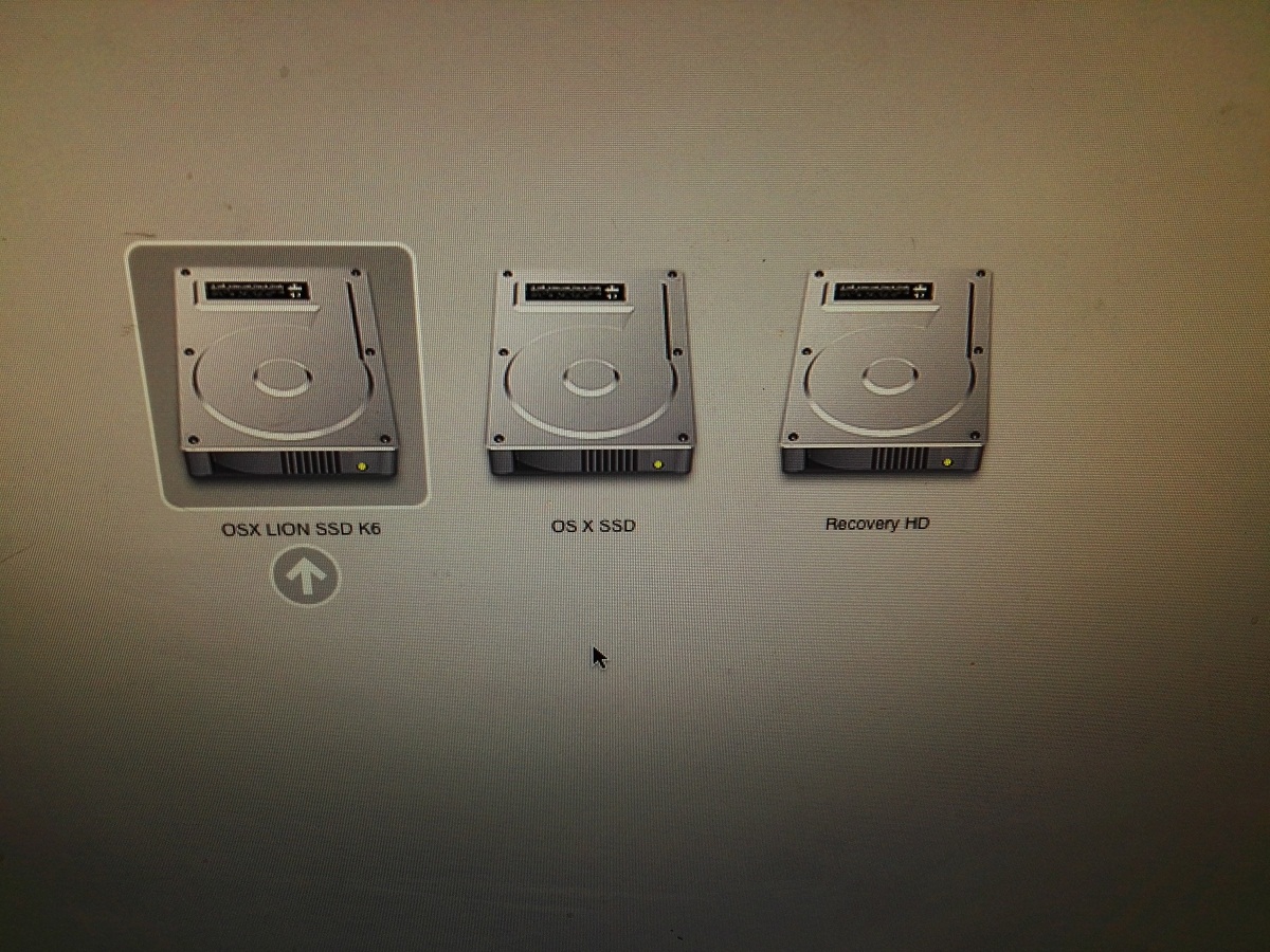

I do get the chime, and the boot up choices, with OSX or windows, but when choosing OSX I just get the timewheel spinng for some time and then white blank screen, with an secondary black cursor at top left at times, and other times just blank white.

My mac pro1.1 went belly up for one moment to the other, so Im a little unsure if its thruely the CPUs that are at fault, and would have reckon it was the GPU GT7300.
anyway to decifer that its thruely the CPUs that are the sinner, before jumping on a new pair of X5355, in regards to if its the old 5150 dual core CPUs that are messing my beloved computer up..

Are your OSes loaded on the same drive? Are you able to boot into the recovery partition?
I would try installing/booting from a USB stick to see if you can get anywhere.
You could also try to boot into OSX while holding Command (⌘) – V, for verbose mode, to see where it stalls out on loading or if there are any errors.

A bit early to start condemning processors IMO.
The 'Chime' suggests to me the CPU, Memory and Logic Board are OK.
My recommendation is to install 10.6 or 10.7 (Operating Systems designed for this hardware) on a USB stick and try boot off that. Spinning beach balls on startup could be sign of software issues.

can you boot from the recovery partition?
do you have a second mac you can use?
do you have the osx install CD's?
