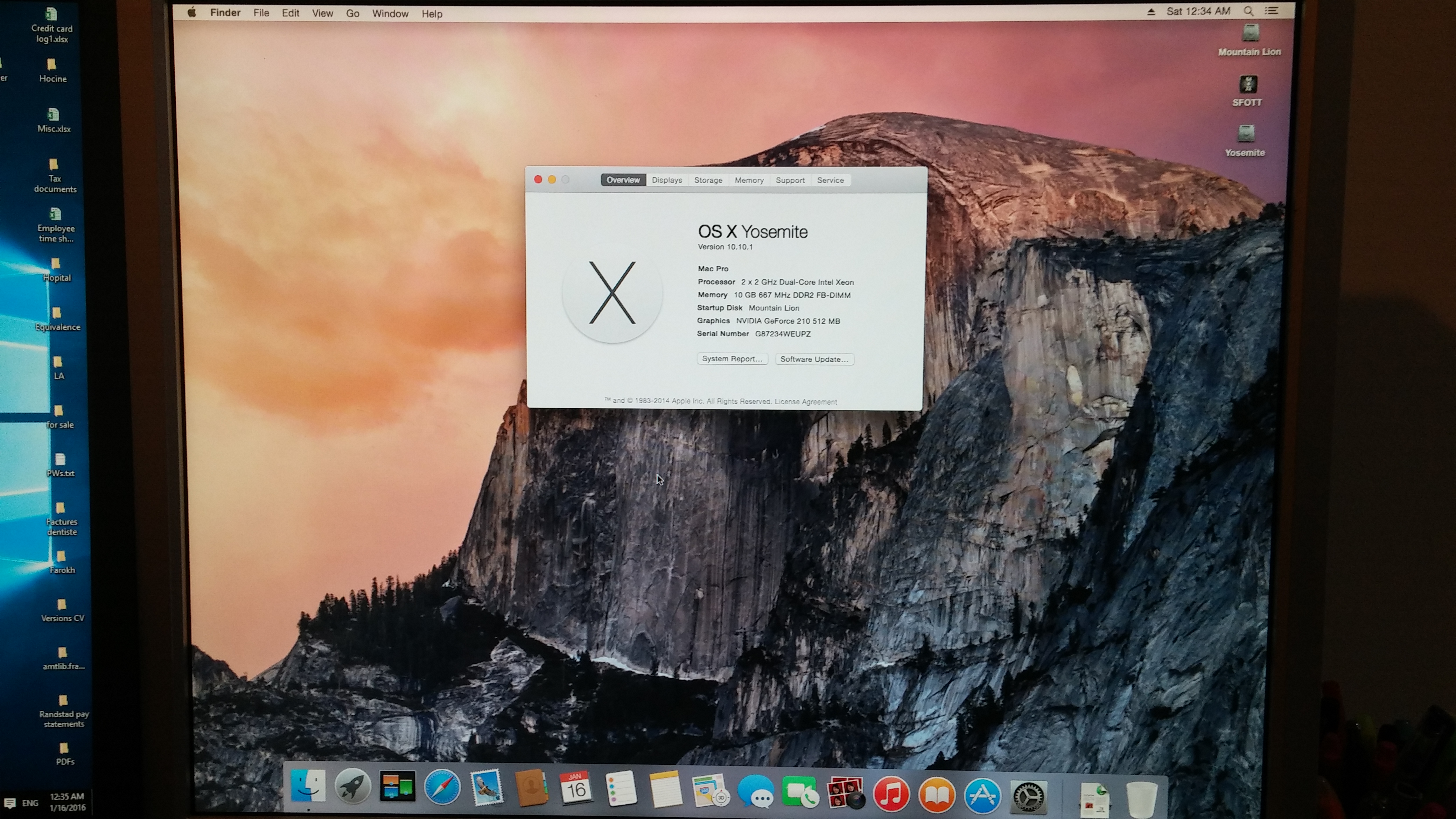

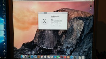

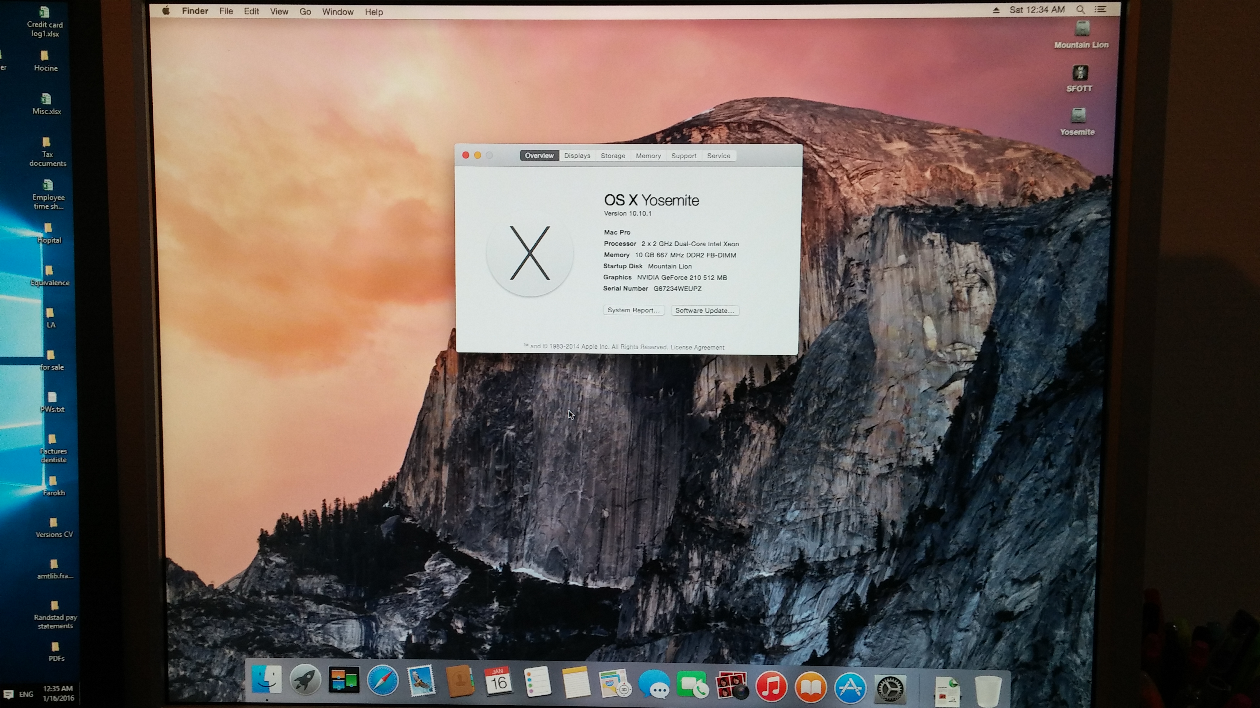

I have a good news. I just did one thing that I never thought would make it work! I share with people who have the same problem. Here is what I did. I removed the battery from the logic board. Pushed the power button and surprise! The chime came back. I replaced the battery, connected the monitor, and it booted up! Here is a pic of Yosemite after it rebooted.
Thank you all for your suggestions. I really appreciate.
I thought the logic board was fried!
