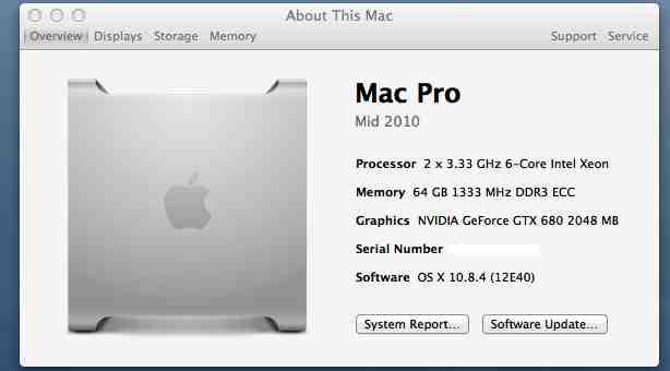

3.33 12 core
I got a Mac pro from ebay without processor and Gpu
Successful upgraded to 12 core 3.33 (got from ebay) + Gainward gtx 680 already flash with macrom
I'm using the system since 4 months without any problems , powered on all the day , launching all kind of benchmarks without any problems.
My set up
Mac pro 2010 2x3.33
64gb ram
Gtx680
4 SSD connected to Atto H644 to have 6g speed (maxupgrades ssd adaptor plus custom cable)
USB 3 Pcie card native drivers ORICO
USB 2 Pcie from sonnet
Custom power cable that draw the power from the bottom optical drive cage to power the two USB cards
