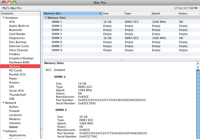

I searched on eBay and found some for $125 each. Bought two for $260 with postage. Not the best bargain around (only $27 each extra for new ones), but I had a bunch of other stuff going from the US to Australia (where I am) and I wanted the RAM included in that shipment. Still, $260 for 32Gb RAM is an ok deal.
I'm still with the standard 2 x 2.4GHz processors, but will be going to 2 x 3.33GHz processors early next year (either four core or six core each, depends on what I can find at the time).
The two 16Gb DIMMs are working fine at 1066MHz, and will be ready to go to 1333MHz when I move to faster processors next year.
Edit: Was stuffing around and just found an eBay listing for the same RAM, with a Buy It Now price of $150 (plus $5 post) for the same 2 x 16GB DIMMS. I don't need 64Gb RAM, but who can say no at that price?
http://www.ebay.com/itm/191005866458
How it appears in the System Profile with the 32Gb:
