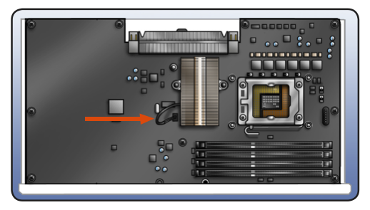

What temperatures and behaviours are you seeing from the northbridge and its heat-sink? I see 60°C and 50°C respectively at idle.
The northbridge and its heat-sink are located under the processor heat-sink block and it has an external lead connecting its temperature sensor to the processor board. It's probably worth checking to see if this lead has become dislodged or damaged.

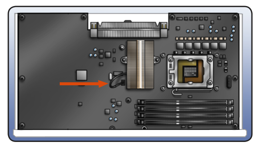

Thanks, I'll double check this
