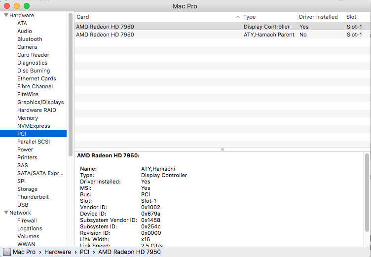

Some cards (AMD) have minor bugs if used unflashed but its rare (although i had it with HD6850 in FCPX).
Some people need PCI info to be functional for various cards they're using, also not possible with unfleshed card (it shows blank/error).
