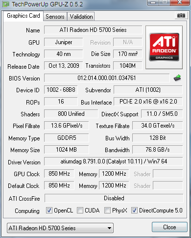

The good thing is that the XFX card is now working in PCI Express 2.0 16x mode - 5 GT/s !!!

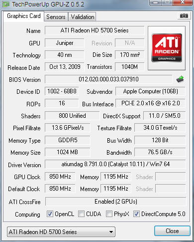

you could try flashing the Apple card with a PC rom 🙄

GPU-Z tells me Crossfire available.
It works ! New Catalyst versions are screwed up !
Only 10.11 and older work with such setup.

The good thing is that my XFX card is now working in PCI Express 2.0 16x mode !
Original:
Flashed:
How it looks like 🙂 You need to mount Crossfire bridge with such cards, but it works !
