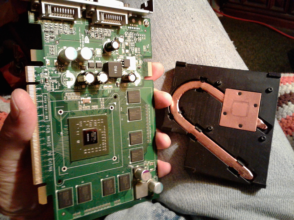

Recently my Mac Pro started spontaneously restarting and/or crashing with the dreaded screen of death.
I had read about overheating issues with this 7300GT card, so decided to pull it out, scrub it clean, remove the heat sink and replace the heat sink compound. Computer has been running flawlessly for two straight days. It had been "crashing" every half hour before finally getting cleaned and "serviced"....I know this thread is old, but perhaps this will help others experiencing the same. Another thing about Apple's poor design, having the card sit so close/nearly touching the plastic inner casing above the RAM risers. There is a scorch mark from the bottom of the overheating card.....may get a pic to add later. May put a small spacer there and look into adding a small fan to the side and keep the hot air moving better. Picture shows the card with heat sink removed, GPU exposed prior to applying new heat sink compound.

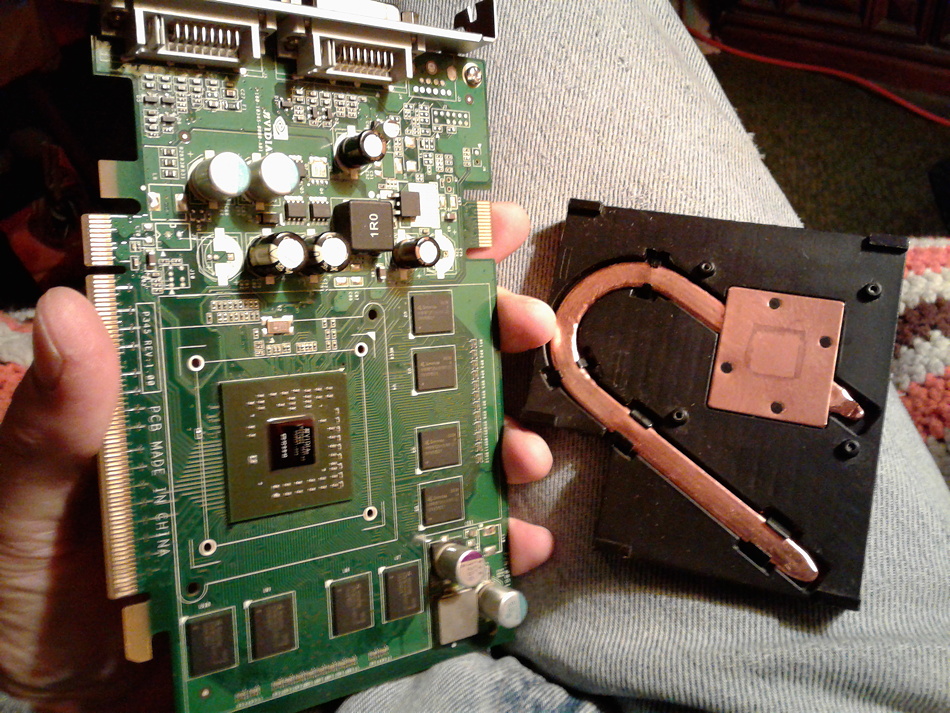

The computer now totally fails to load the GUI after logging in with safe mode and I have been unable to find a command to find the GPU type from the command line via SSH. Attatched is a photo of the card, which appears to be a 7300GT.
