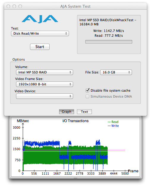

Mac OS X 10.7.4 boots from two Intel 520 SSD 240gb in RAID 0 connected via Areca 1882-IX-12 with these results:
IF you notice the speed differences between the RAID 0 on the ICH (on-board SATA ports) vs. the RAID 0 on the ARC-1882, you'll see quite a bit of a discrepancy.
This is the result of the ICH itself, which has it's throughput capped (~660MB/s) to keep it from consuming all of the bandwidth that connects the SB to the NB in the 2008 (other things on the interconnect as well, such as USB, Audio, and Ethernet ports).
