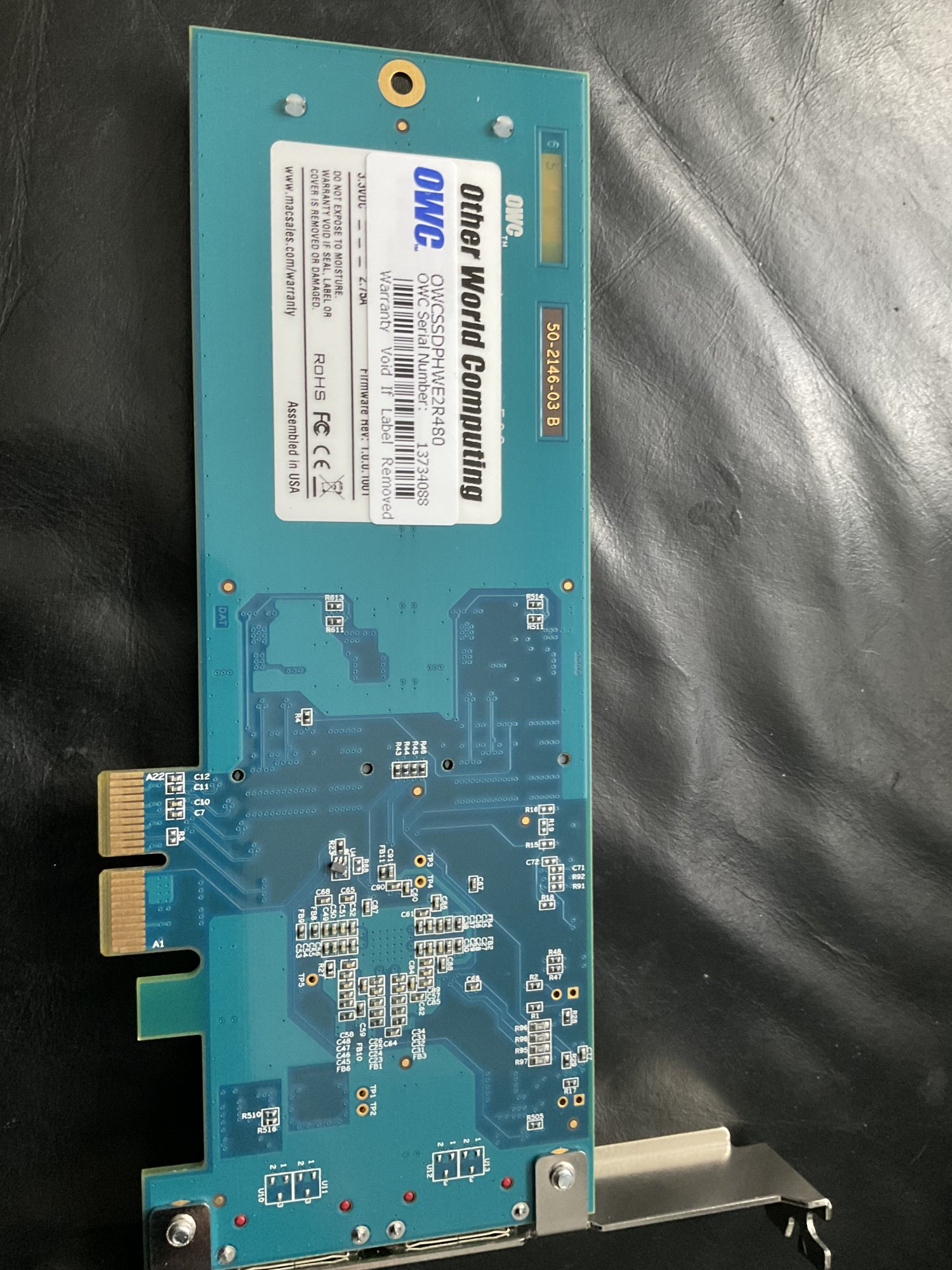

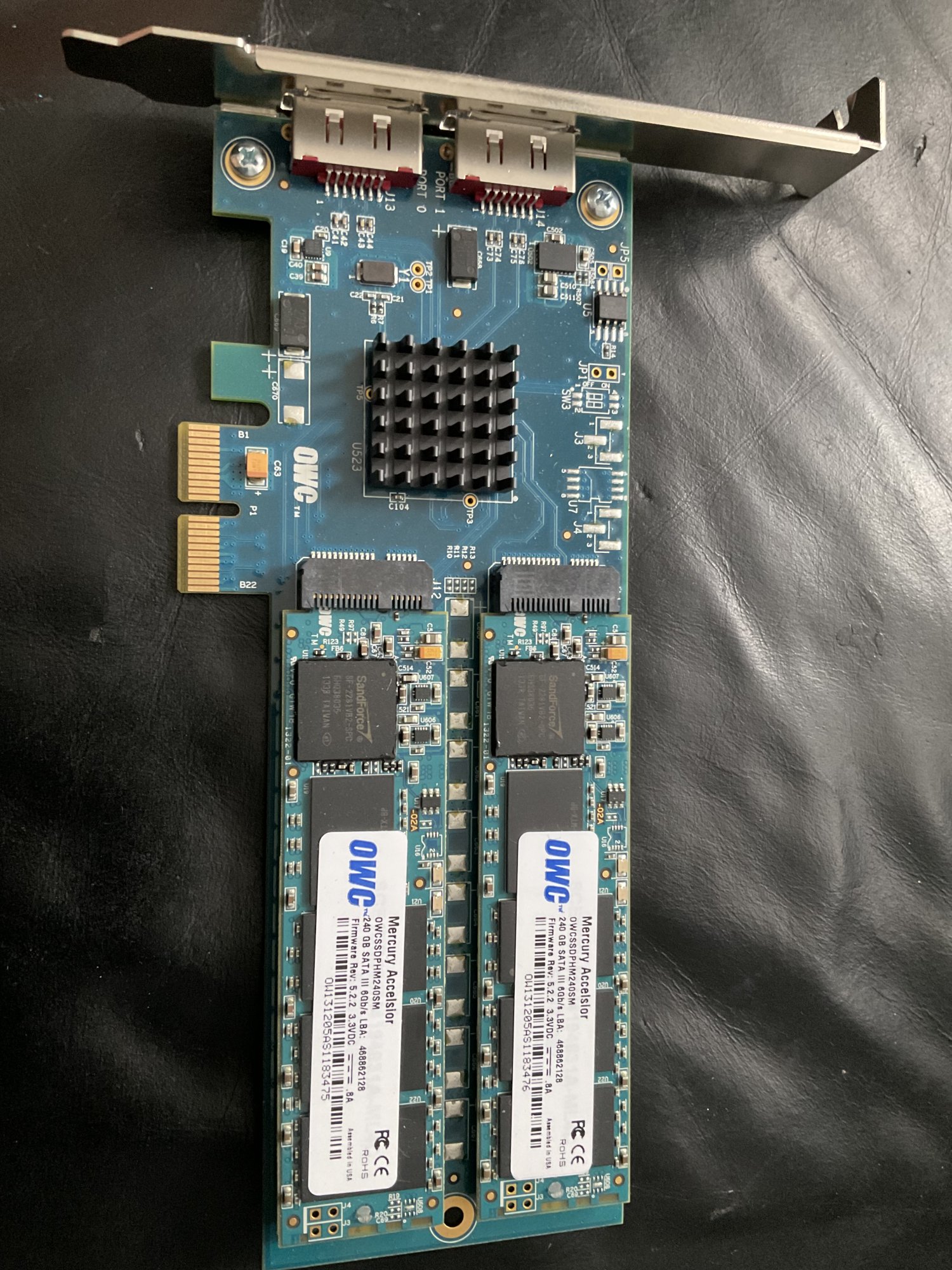

I’ve pulled this and the machine can’t find the boot disk so I reckon this must be it, in the pci slot below the graphics card.
Thanks again folks.
Thanks again folks.
You got super lucky. This PCIe drive used to be expensive and fast. Your MP3,1 should run a bit faster than your old one. OWC used to have great SSD solutions for Mac. With what GPU did the unit come with and what GPU was in your older unit?
