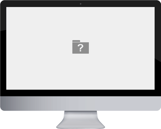

If you replace your current graphics card with a Mac Pro card (not a flashed/unsupported compatible one) you will likely see something a grey screen with a ? folder, similar to this:

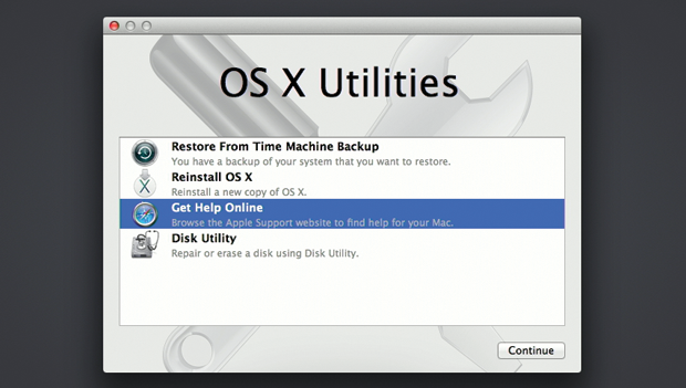

Once you can see that, turn off your Mac. If you have the recovery disks for the machine the insert them and boot up and hold Command (⌘) when you hear the chime. If you don't have the recovery disks you may be able to recover from the internet. Locate the command (⌘) and R key and boot up while holding these keys.
If everything goes well you should see a screen asking you to install Mac OS X as well as a few other options. It would be an idea to use disk utility (one of the options on the screen) to format your new hard drive before installing OS X.
After following the steps through and waiting while your computer downloads the Mac OS X software you should have a fresh install of Mac OS X on your Mac Pro.
