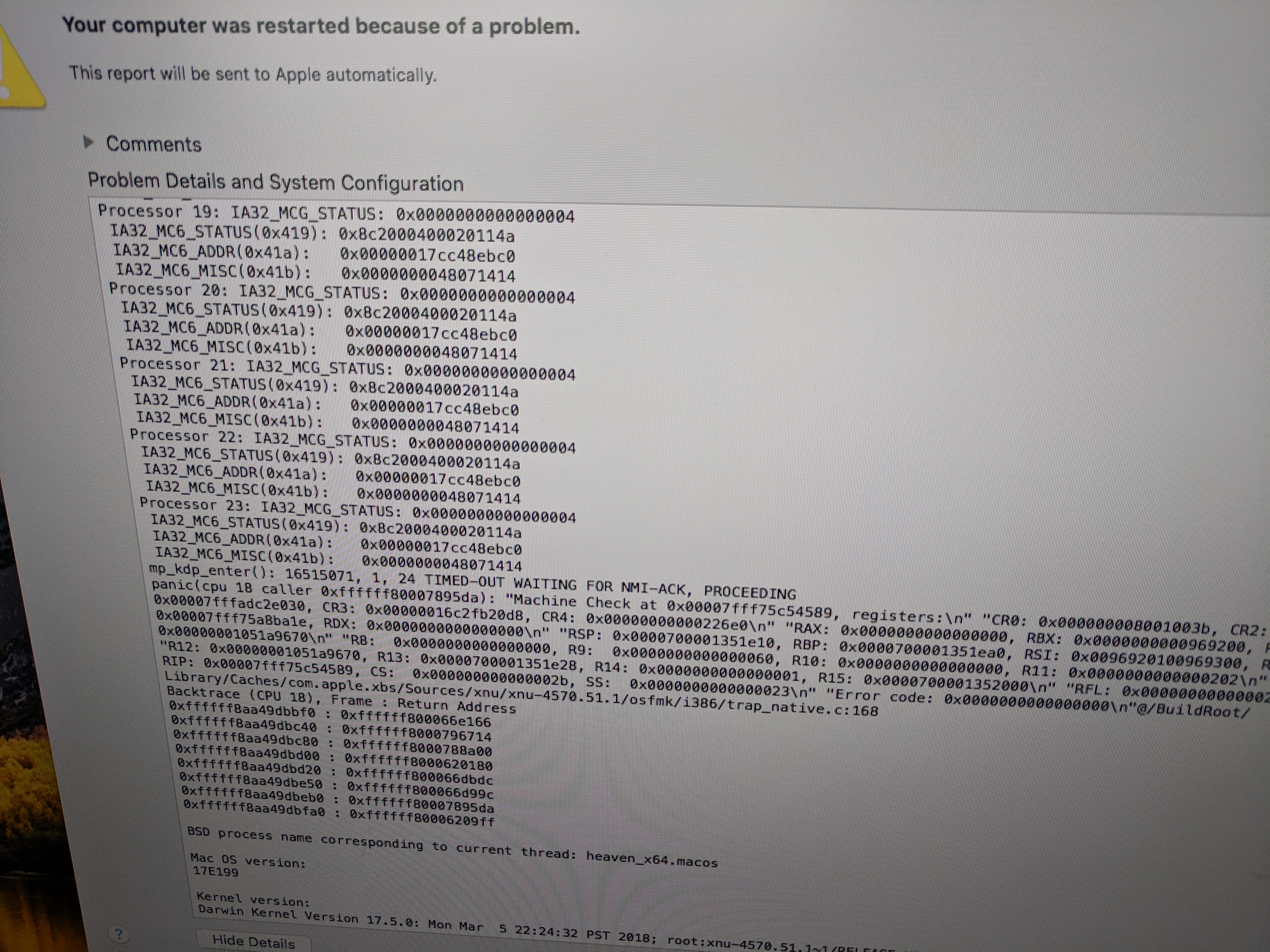

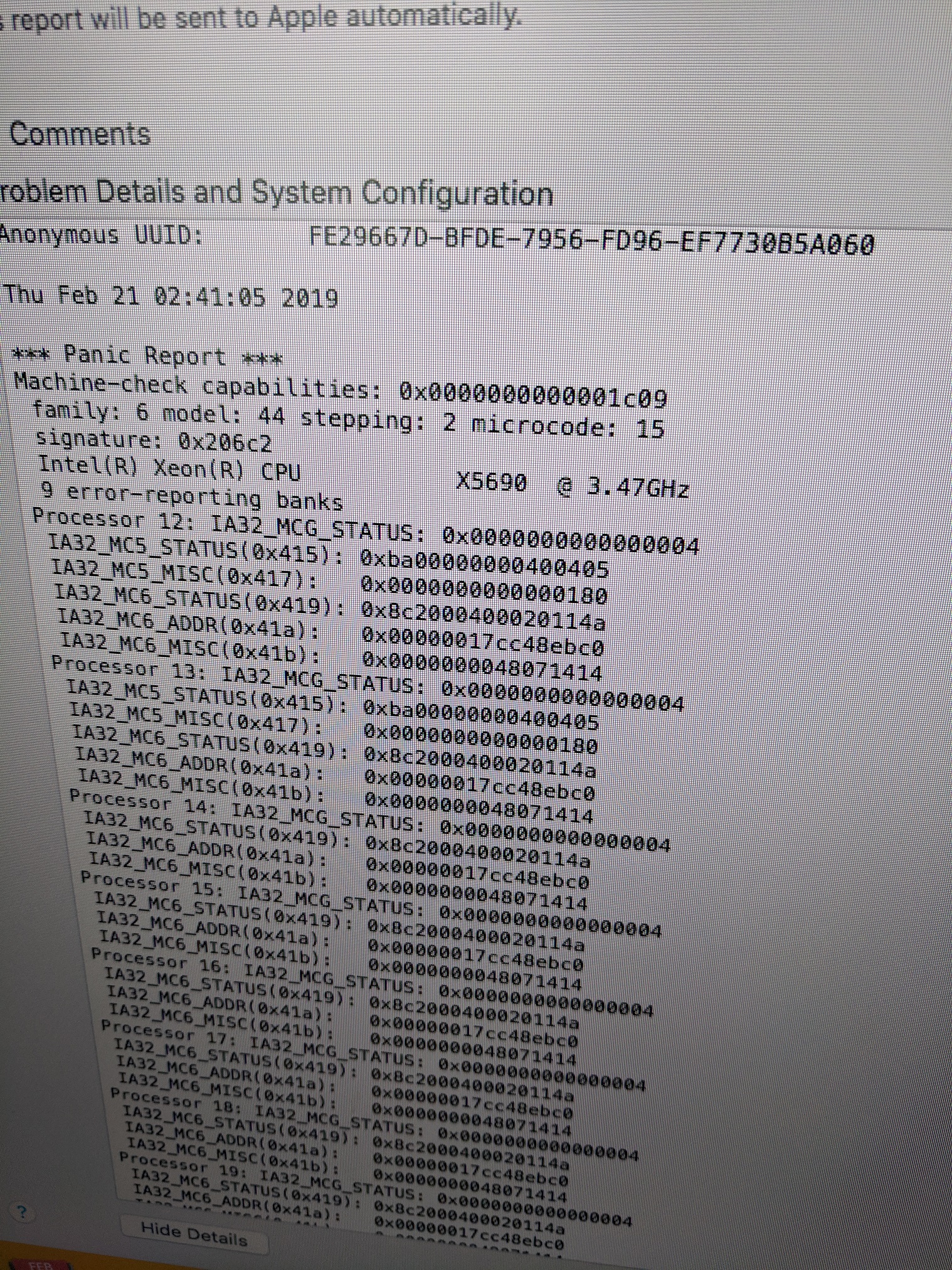

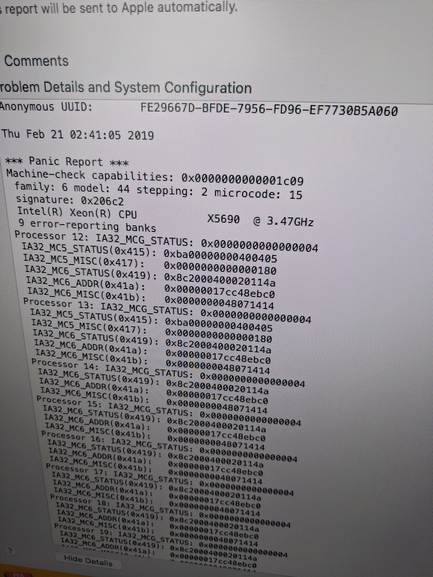

When I run a geekbench and a heaven bench paralel this Kernel crash occurs around the end of the test, see picture.
Am i right it is one of the CPU failing to use the memory properly?
Strange as all working fine if the unit is not under stress.
Any help would be appreciated.
The motherboard and other seems working fine as I replaced the daughterboard and run the same tests successfully. Although the replacement doughterboard has only 1 CPU, while the problematic one has 2

second picture

[doublepost=1550760988][/doublepost]and the first picture

Can you attach the report from:

NMI errors usually are caused by problems into QPI links. It's a 2009, processors were changed?
I did this upgrade like hundred times, and yes it is dual 3.46 hex CPU from factory 2.226 quads.
Does this QPI link error related to the daughter board or the CPU? Or even the motherboard as I did not have the chance to test the mac pro with an other dual CPU daughterboard and single CPU board requires no QPI.
Plan is to get an other unit upgrade it and if that works 100% swap the doughterboard and see what happens.
