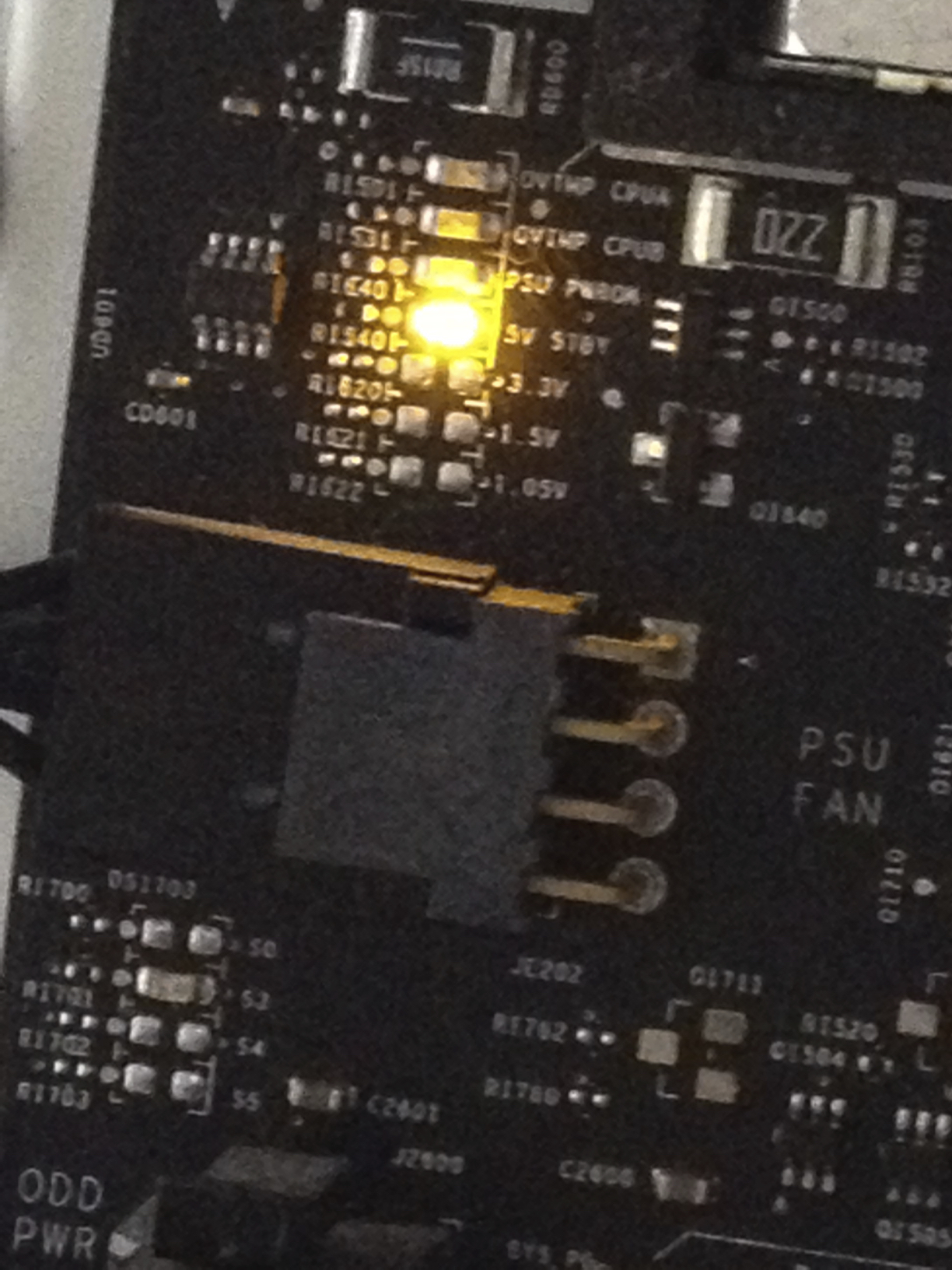

Mac Pro 2009 Non Boot No Chime no power
Dear All,
It happen again and seems this time its much worst. !
Even i removed and swap CPU it won't work. Ive even place back the original 2.26 CPU also no luck.
Ive even disassemble everything and left the back logic board and assembly back again with a new PSU also nothing happen.
What can i do now. I need to atlas know what rent wrong before i can jump into a solution any Guru out there could help.

Dear All,
