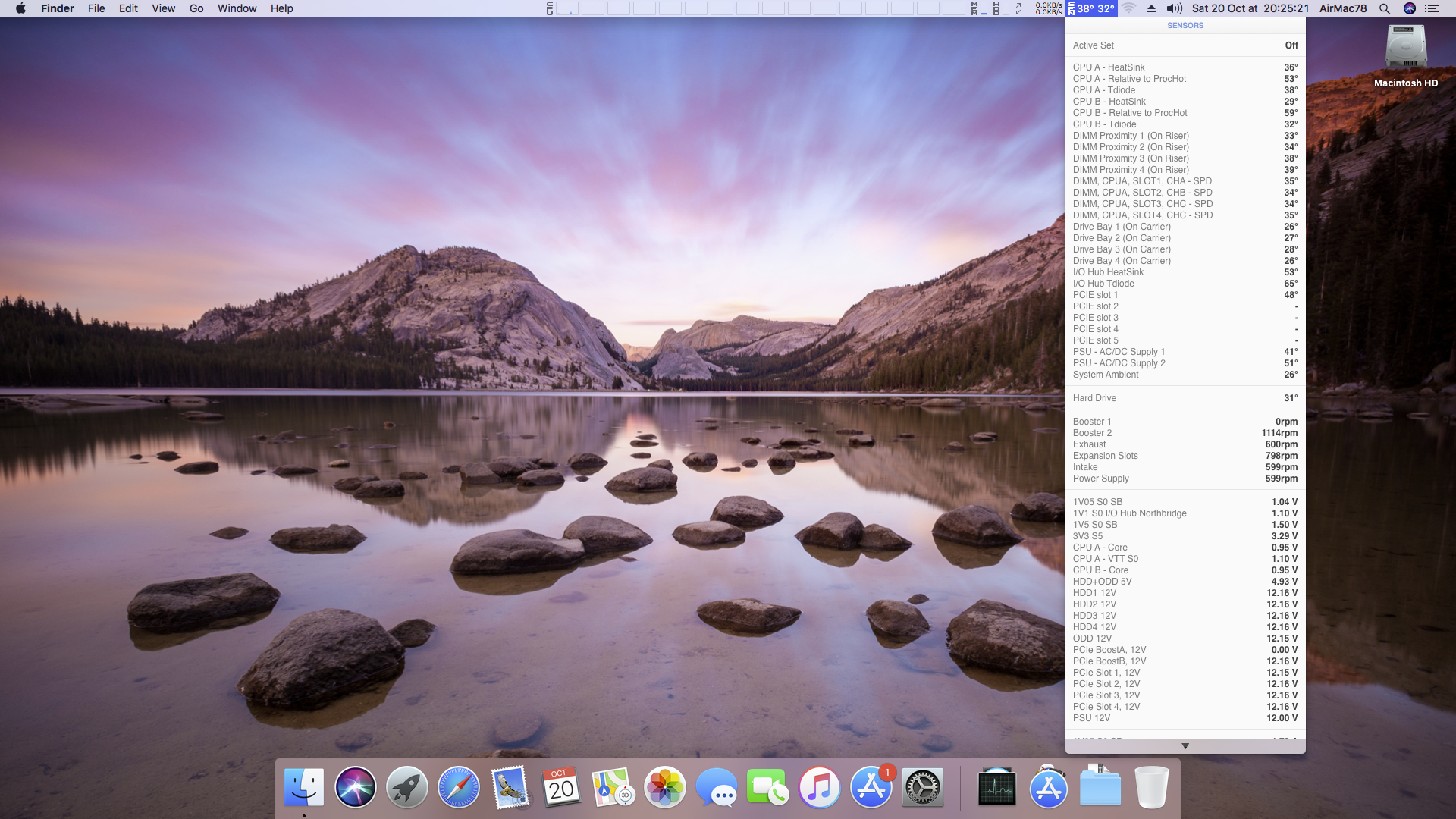

Now, i've found that if i unscrew 1/4 the CPU's Heatsink, no noise at all. But, again, BoosterA is at 0 Rpm and the CPUA is under 39°/38°, while CPUB is under 32° on idle. Hour a go, I've tried to install windows 10 Pro, in UEFI mode, after the Mac rebooted to continue the installation, it shutted down itself, tried after that to power it on, it doesn't. So i've taken the CPU-Tray, and i've found that the CPUA heatsink is hot, while the CPUB not.
I don't know what to do, now under High Sierra, cpu fans are running quietly, and here's a screenshot of iStat Sensors.
Did you checked the heatsink fan connector? Some people break the tabs to install lidded Xeons.
