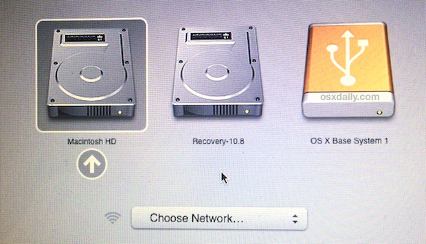

still holding alt at startup will revival if you have a boot volume or not.
may also be something simple like the HD is not correctly seated or you need to change the drive bay
just boot up holding 'alt' and you will get to the OS selection screen
will look something like this.
if you see no drives then something is wrong, try changing the bay the HD is in and see if it still dose not show up.
if you still cant see anything then you will need some form of boot media (install dvd of osx or usb stick with osx installer on).
once you have that you can have a look to see whats going on with disc utility or just reinstall osx
if you have a second mac you can also boot your macpro in to target disc mode and look at the HD to see what data is on the drive if any.
