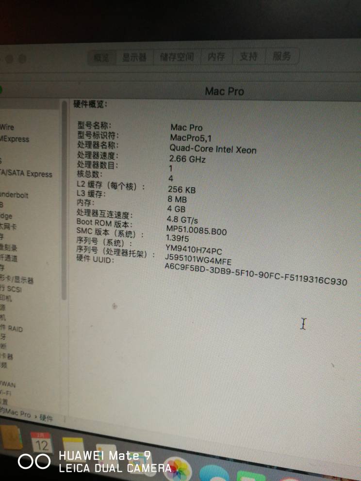

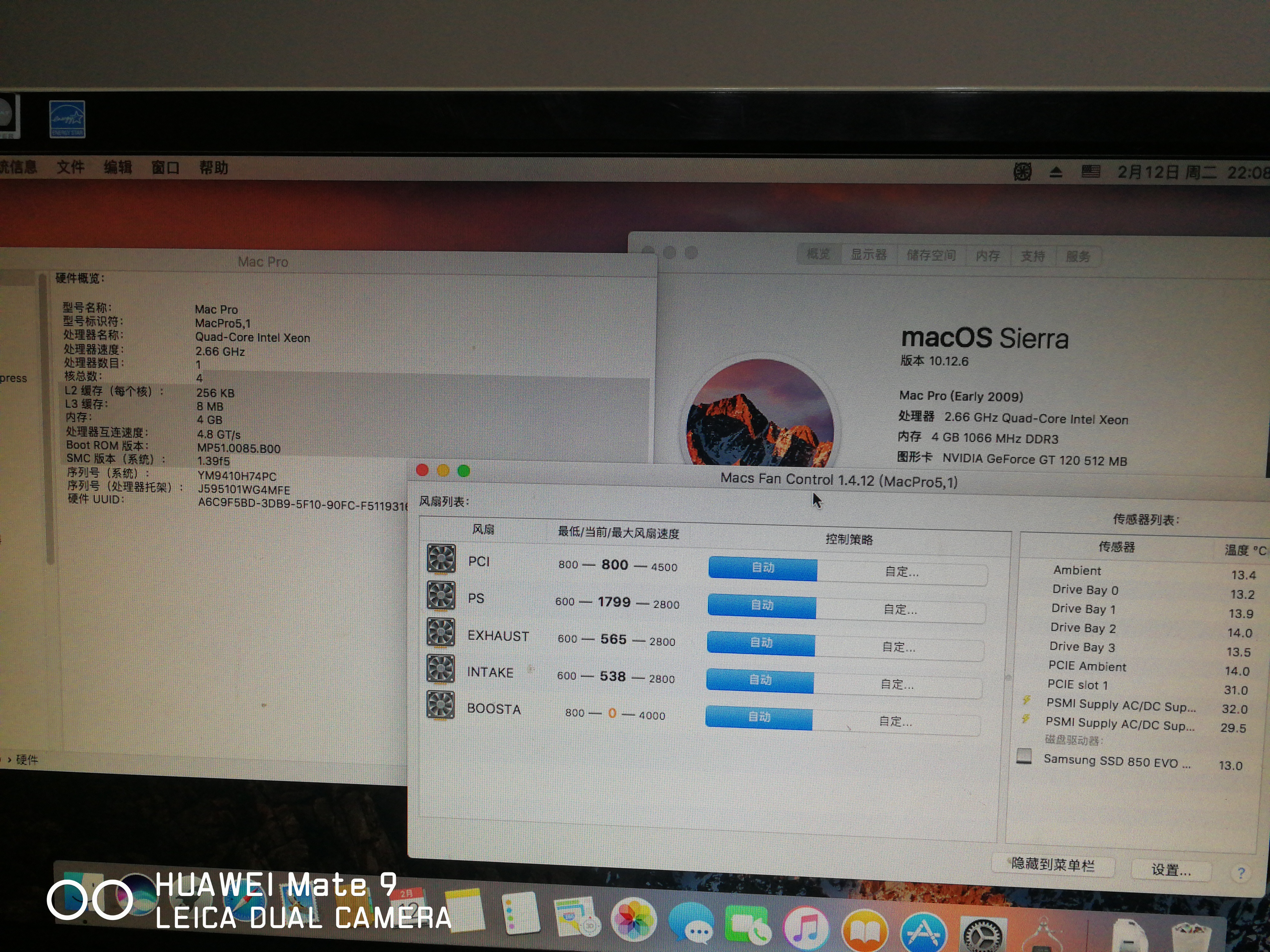

MAC PRO 2009 upgrade 5.1 ,CPU front rear fans ,PCI fans are in the highest speed, can not automatically adjust the speed, what should I do, can anyone help me?
The fan speed displayed by macs fan control is incorrect.

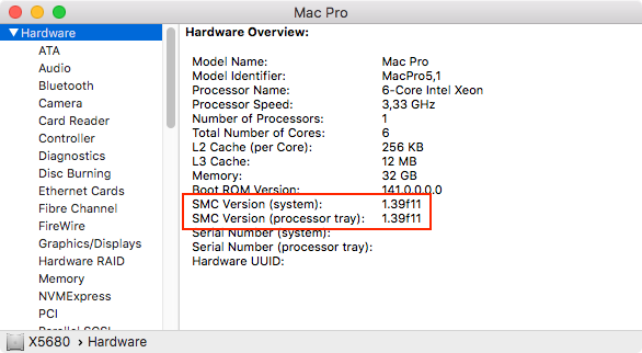

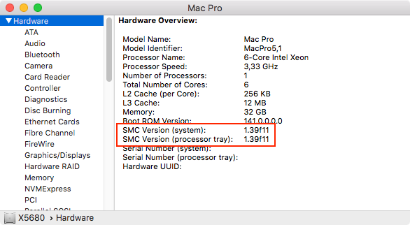

Check if your CPU tray is from a real 2010/2012, it will not work with a 2009, SMC mismatch:
  • 2009 trays with 2009 backplanes - SMC version 1.39f5 for both
  • 2010/2012 trays with 2010/2012 backplanes - SMC version 1.39f11 for both

thank you very much。in my picture,my mac pro 2009 SMC only is 1.39f5.but your mac pro SMC have two,system and cpu trays both are 1.39f11? why? can you help me?

My Mac Pro is a 2010, so the two SMC versions are 1.39f11, yours should be 1.39f5 for both since it's a 2009.

BOOSTA is the fan installed into the heatsink of CPU A. Shouldn't be showing zero…

PCI = PCIe fan
PS = Power Supply fan
EXHAUST = CPU cage exhaust fan
INTAKE = CPU cage intake fan
BOOSTA = CPU A heatsink fan

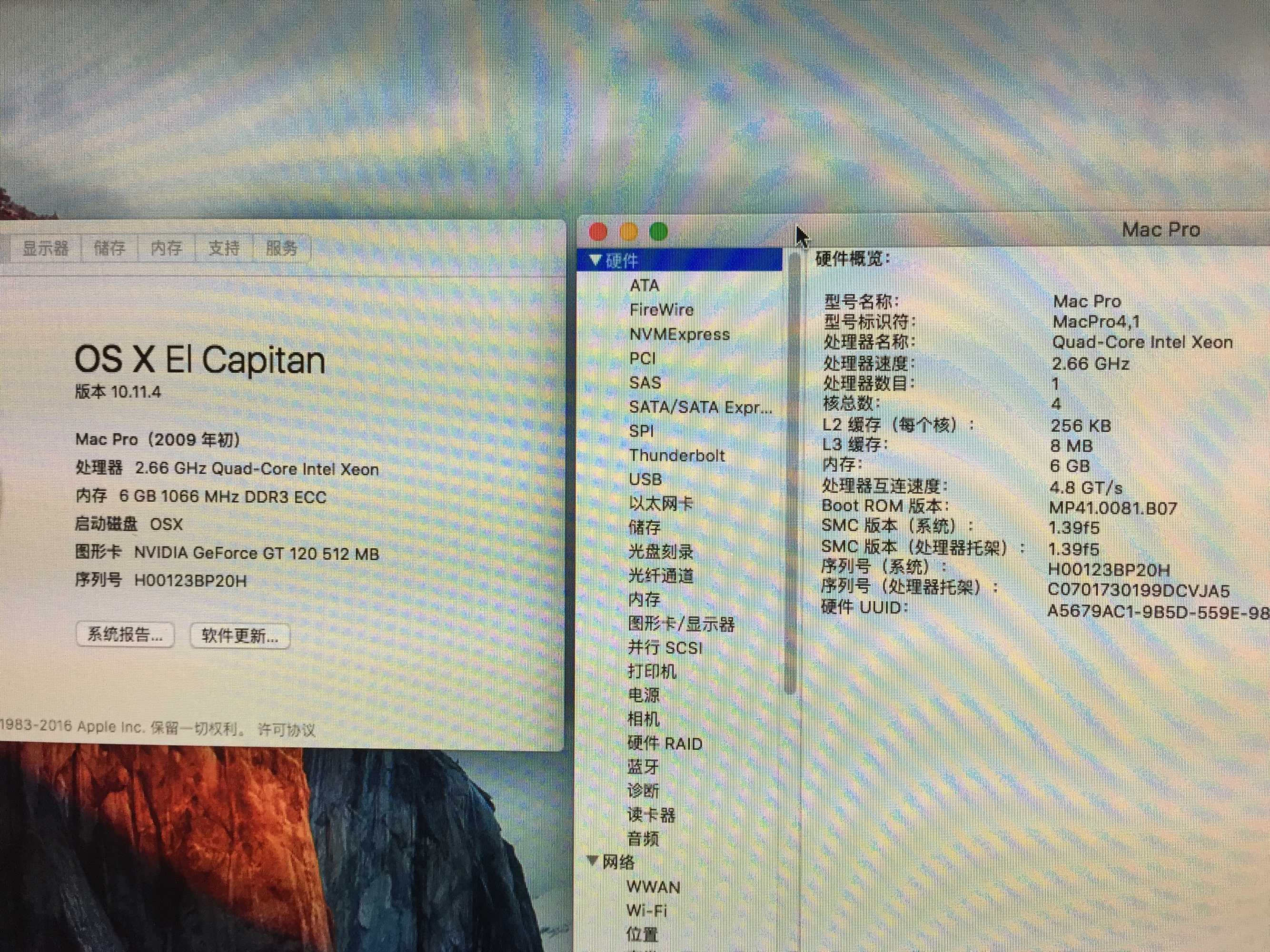

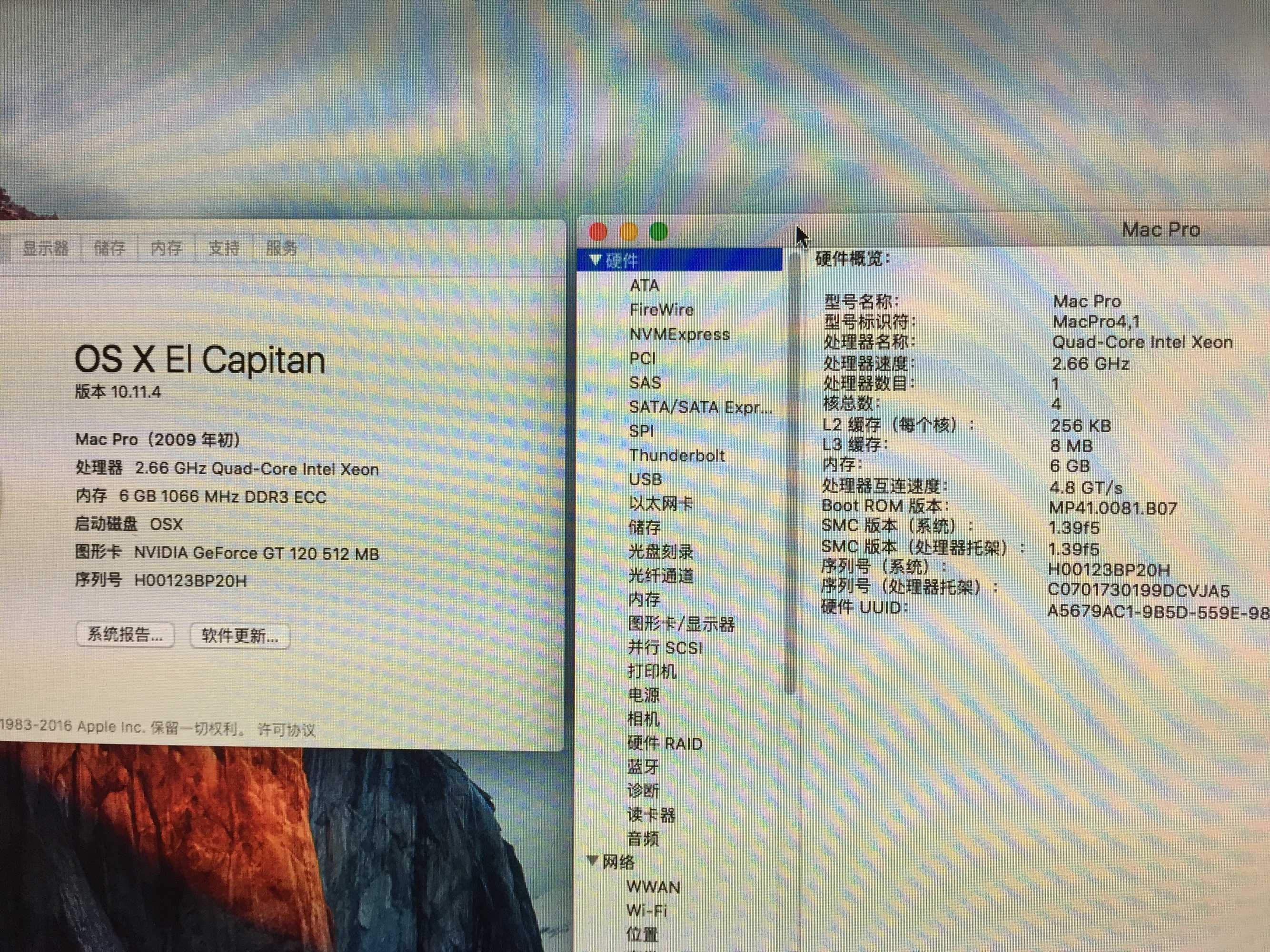

I'm sorry to bother you again, but today I bought another Mac Pro 2009, which I call B, and the one that had the problem the other day was called A. Mac Pro B has little sound. I changed B's CPU tray to A's motherboard, the sound is also very small, the fan is low speed,. Switch the CPU tray of A to Mac Pro B, the sound is still very large, the fan full speed. I've carefully checked that Mac Pro B has 2 SMC serial numbers, but Mac Pro A has only 1, and there is no CPU tray SMC serial number. is not the CPU tray of Mac Pro A is bad. But today I was told that my CPU tray was md560

I take CPU tray AT to mac pro B, Mac Pro B have one SMC verizon. it is the system SMC verizon. The CPU SMC verizon is not displayed。
So you proved that the problem is the CPU tray. I saw similar problems with corroded trays.
