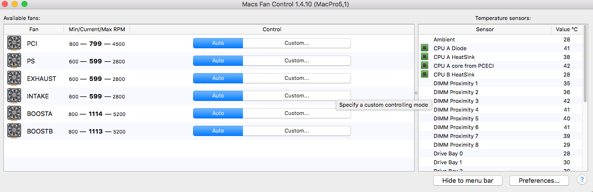

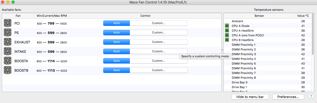

Hi, i performed the upgrade of a 2009 Nehalem 2 x 2.26, first i did the firmware from 4.1 to 5.1 and then the CPU's with 2 x X5677 @ 3.46ghz,i didn't delid the cpu's and i used washers. i first tried with CPU A only and once successful i proceeded with CPU B. The mac boots up, no red lights but bizarrely CPU B doesn't show up in system report nor the ram on CPU B. I tried to tight a tiny little more but fans get spinning right away so i backed up. I tried to reset pram and smc but still no go. It's really weird also because macs fan control app shows temp and fan speed for CPU B ... anybody has a clue ? i've never red about this behaviour on forums 🙁
EDIT : i swapped cpu's to check they both worked and they do but while checking macs fan control i think i'm missing some sensors for cpu B ?

EDIT : i swapped cpu's to check they both worked and they do but while checking macs fan control i think i'm missing some sensors for cpu B ? View attachment 778130
