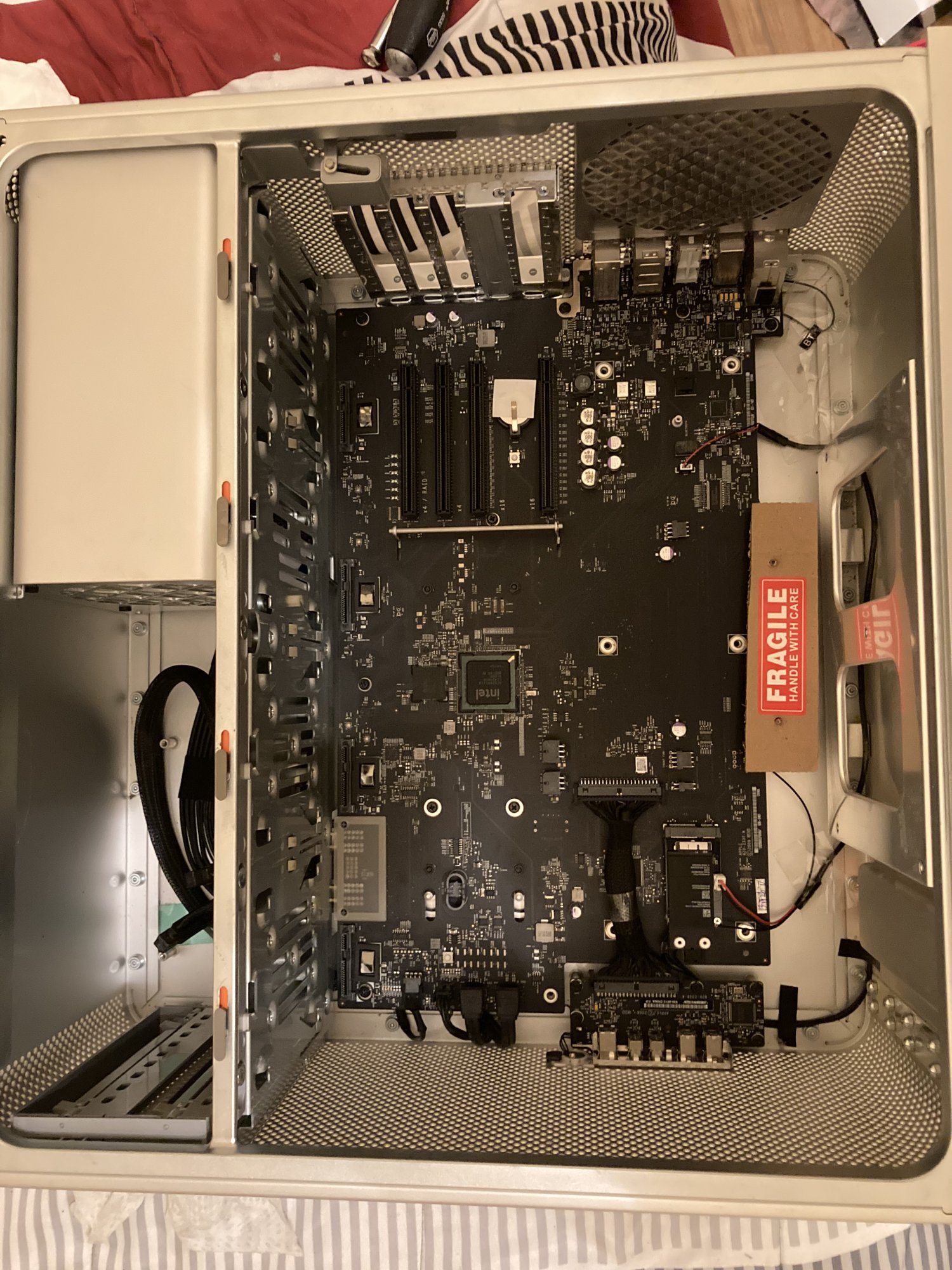

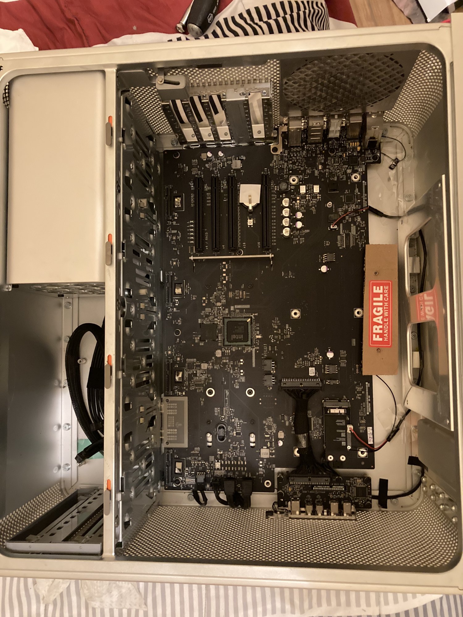

I have been dealing with this for a few years, I found with a usb drive with led in it, Plugged into the front usb slot. the first button push will not get anything started, then a long button push to shut down, the second boot works every time, you need a usb with a light to see it, it will show first boot, and when it shuts down, the led on the Mac Pro button does not light up till second boot.
Today however, i went full shotgun to get this fixed, I replaced the back plain, the power supply, the button board, and updated the WiFi (ac) and Bluetooth to 4.2. For good measure..
Have high Serra , and Mojave working great, sleep, handoff, Apple Watch wake, all that stuff working.
With Catalina however, I have many small issues, refuses to even wake, much less unlock with my watch.
Not so hip on Catalina at this point,
I did loose windows 10 in the whole mix somehow..
it’s nice to have things working correctly for a change.
But it did cost.
