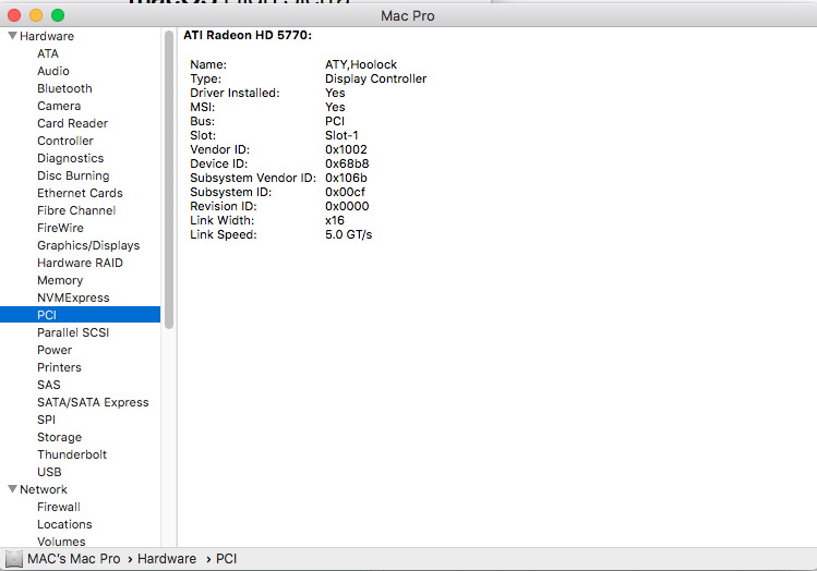

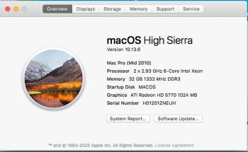

I just purchased a refurbished Mac Pro 2010 with 2CPUs 2.93GHz. The video card is ATI Radeon HD5770 1024MB . I did PRAM reset but it didn't work. The MAC does not have any chim sound when booting up. when doing PRAM reset, it has only 1 chim sound and the login screen show up. Attachments are the screenshots of the system and PCI card. Does anyone know what the problem is?

Probably no real mac-card, seems it is a normal pc-card flashed with the vanilla mac-rom. The framebuffer-personality "Hoolock" is the right for the original mac-card, which has 2 mini-displayports and 1 DVI-port.

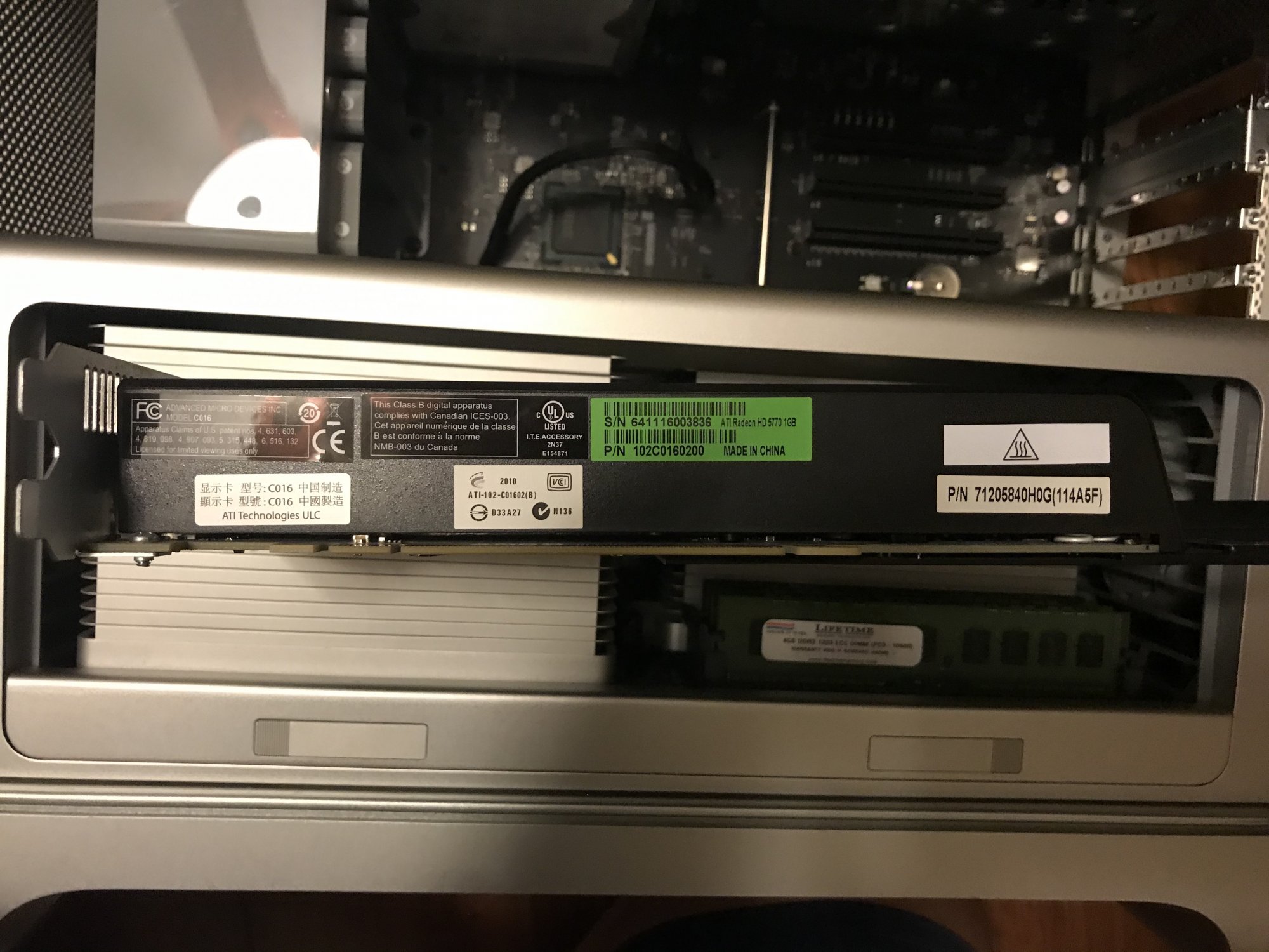

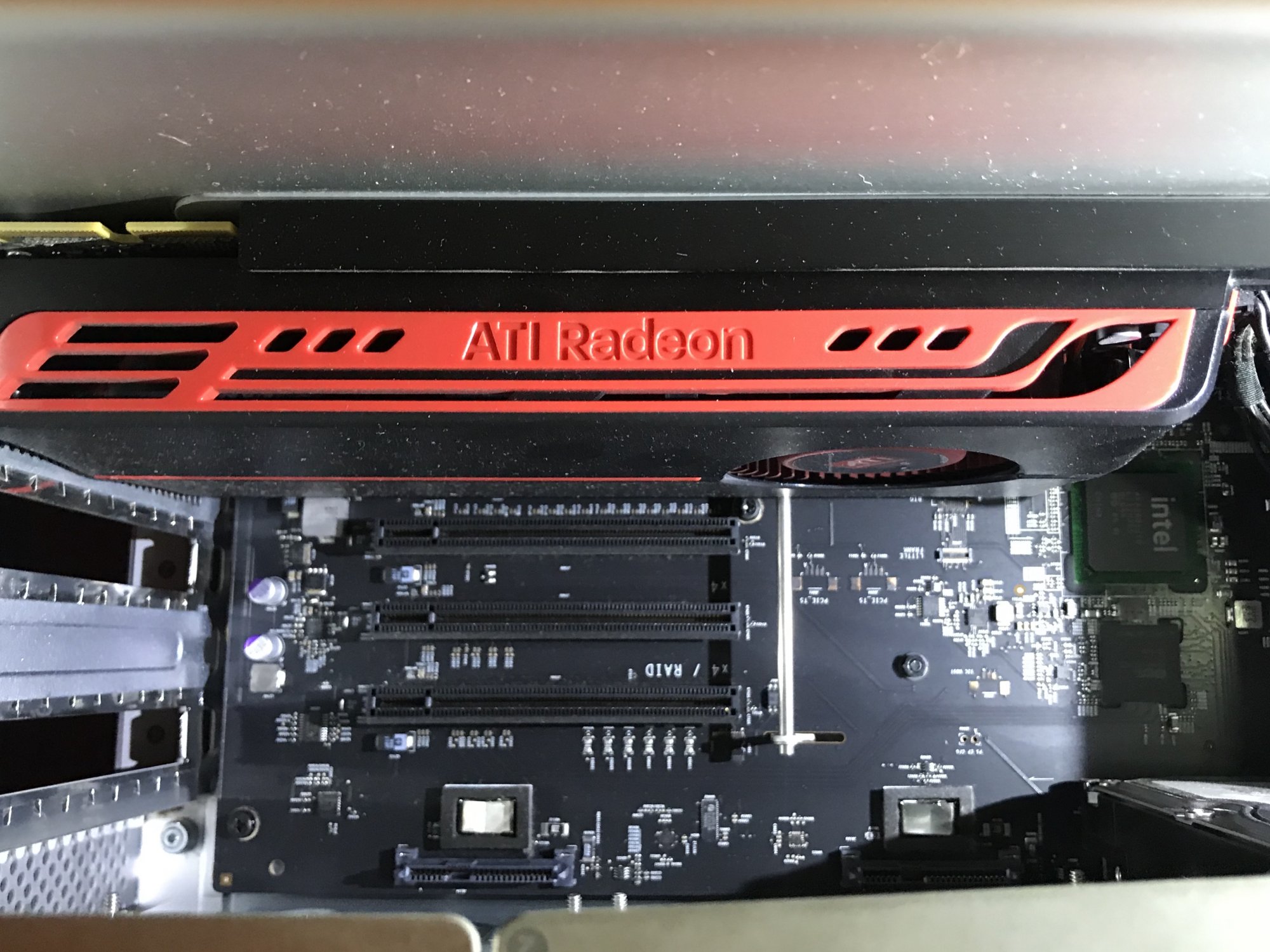

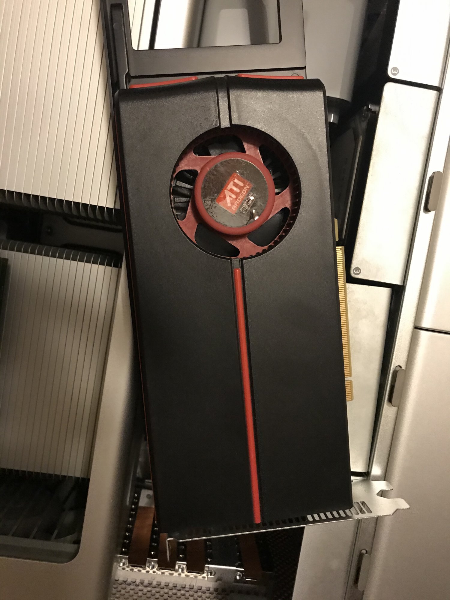

Attachment is the picture of video card. Is this Mac or Windows version?
Looks to be an actual Apple card. Not sure why it’s not working. Try another slot? I’ll check mine out tomorrow, but mine looks exactly like yours. The Mid 2010 and Mid 2012 shipped with that card stock with an optional upgrade to a 5780.
