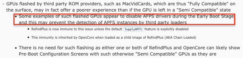

It could be. Some cards flashed by MacVidCards are known to fiddle with things in the early boot stage. There is no issue with this if going on to boot Mac OS directly but it can lead to problems with using third party loaders.
The MyBootMgr guide has this to say:
You can try running the process with another card to exclude this as a factor.
Thanks Dayo. You're right I should try another GPU first to confirm. It is odd that the RX 580 works fine with an older version of OCLP and Catalina though. If it does turn out to be the flashing can it be fixed? or do I have to dump the card?
Thinking about it, if it is because of the MVC/APFS issue, you should be able to get things working by the "EnableJumpstart" key to "true" in OpenCore.
This is equivalent to the "SupplyAPFS" feature that overcomes this problem in RefindPlus.
