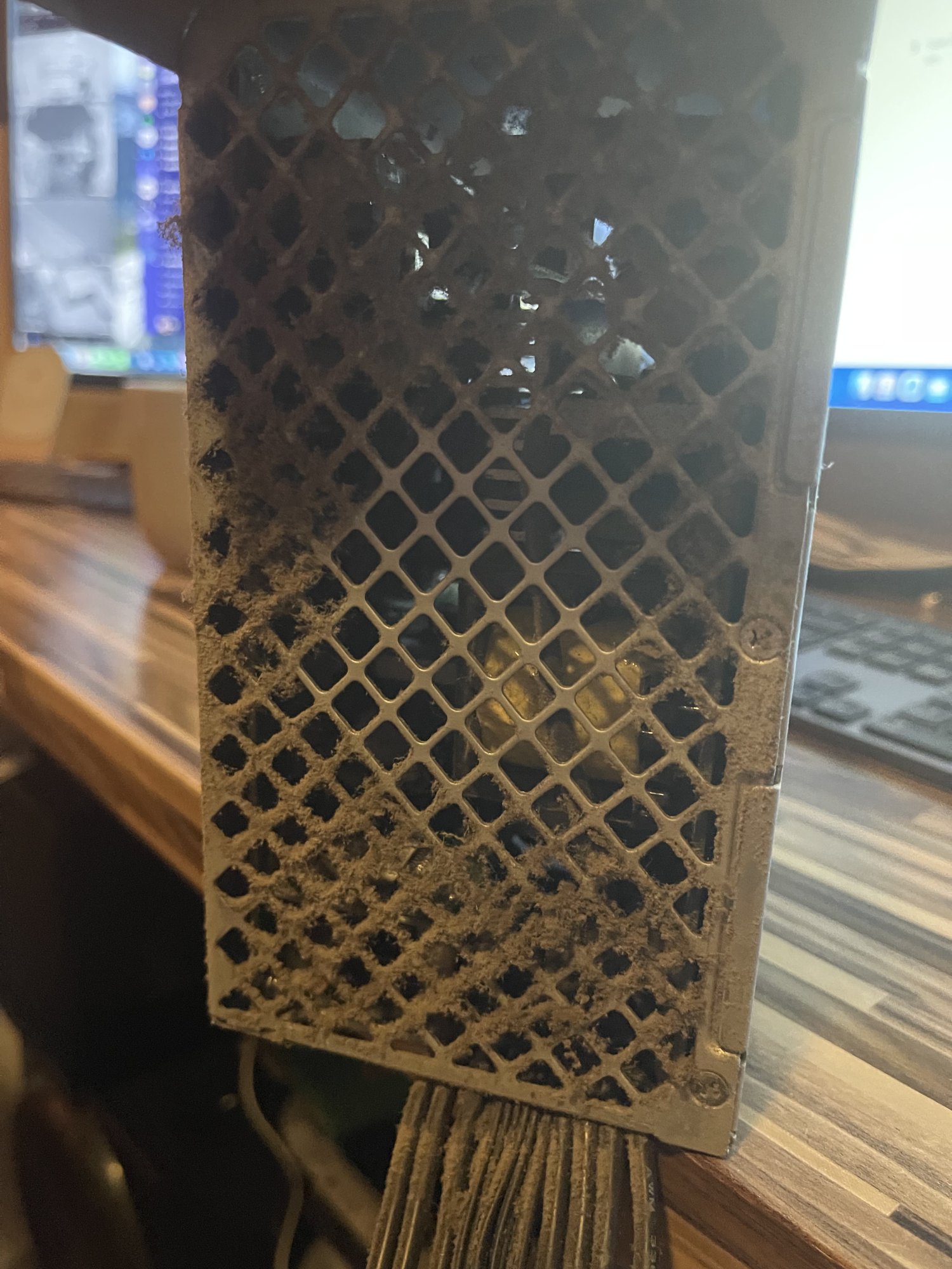

So I pulled out the apple technician manual, basically the board is getting power but not enough to complete its diagnostic check, hence why the amber 5v led is only on when the button is pressed, I've ruled out the back board as the issue, as the red led's don't flicker on when the power button is pressed, leaving just the PSU left.
So I've pulled the PSU and it's pretty clogged anyway, so I have one on order. Hopefully this is the problem!
