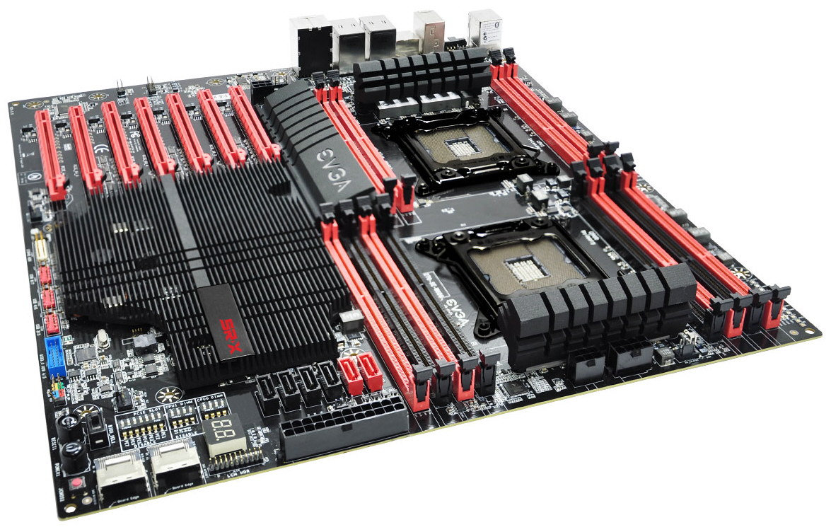

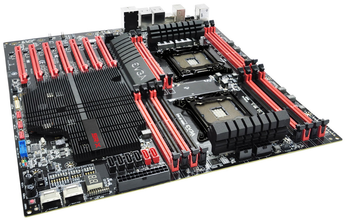

The EVGA board supporting a Core i7/ E5-1600 Xeon if only using one socket thing is interesting - if accurate.
