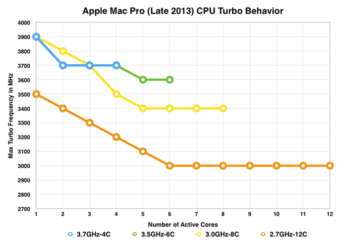

I strongly recommend reading this article from Anandtech, it explains in great detail the breakdown of the CPU's and the way their turbos work - illustrating just what clock speed you get when using different numbers of cores at once.
http://www.anandtech.com/show/7603/mac-pro-review-late-2013/4
See the graph here:
You can see the green line is the 6 core model where it is faster than the 8-core model when using 4, 5 or 6 of its cores. The 8-core was faster when using 2 cores, and equal speed at single and triple-core usage. I would hazard a guess and say if 100Mhz makes a big difference to you, and your general daily use is basic stuff, then the 8 core is probably better, but as soon as you start pulling 4 cores or more, then the 6-core has a slight advantage. Obviously if you need more than 6 cores, then you have no choice but to go 8 or 12 cores.
If a program can use more than 4core is very likely that it will use of all the present core and the 6core will be soon outperformed by the 8core. Since the op need this machine for 3d render and money is not an issue the 8core represent the best single/multicore combo.
