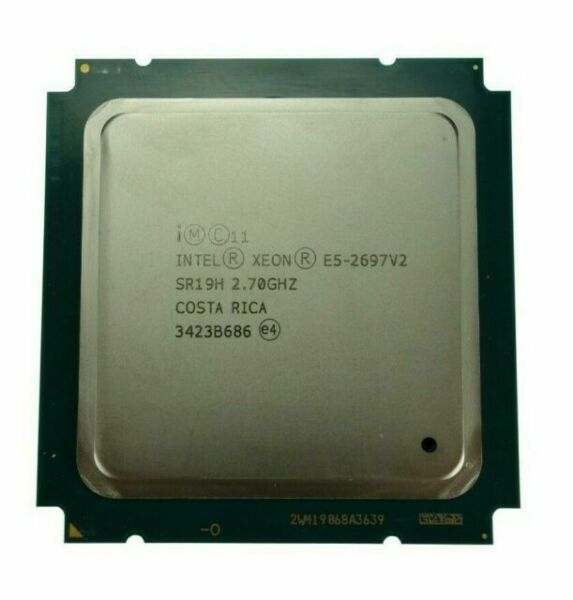

Noticed that OWC is charging $299 for the Intel Xeon V2 3.0 10 core USED while prices on ebay vary from $25-$110
My problem is some of them are different shapes and I want to make sure I get the cheapest (around $30-$80) yet COMPATIBLE version for my Trash Can Nuclear Reactor Mac Pro. Id hate to spend 2 hours taking it apart and 2 hours putting it back only to realize i bought an incompatible CPU
Here is the one i was told to get Xeon E5-2690 v2 Processor
If someone can post a link to it that would be awesome. Id rather save $200+ if i can
There should not be any differently shaped E5 v2 compared to each other, at least I cant find any on ebay listings:
Just don't buy a QS or ES ones and you are better off with it. Then, you can just hope for an honest seller.

early-2013 Mac Pro only works with IvyBridge V2 Xeons, won't work with the older V1 or the newer V3 (and newer ones).
Just be sure that you found a V2 Xeon. The full list of supported processors is listed on the first post below.

All IvyBridge Xeons V2 have the exact same socket FCLGA2011, while V3 have a different socket, FCLGA2011-3, the change was needed to support DDR4.

I notice some say "Malay" and some say "Costa Rica" are either of them fake?
These are Intel factories that assembly and test the dies, there are several.
Thank you sir. I seem to have found a decent priced one. If you wouldnt mind checking it over before I purchase, that would be great. I thank you! 🙂
Specs match, should work fine with a MacPro6,1.

Go with any E5-2690 V2 or 2697 V2, just make sure it is from a reliable seller and if you can test it in a server or workstation before installing it in you mac pro that would help to avoid confusion/no boot etc...

you can run the 10 core version still the 12 has quite good single core bost and owerall better imo
Reactions: PresidentRoss
the 12 core has a bigger cache on the chip and the multi core scores are definitely higher.
Maybe the 3.0 10 core might have a slightly higher single core score. BUT most software today is engineered for multi core. So if you can afford it, the 12 core is a better CPU.

Just get the E5 2697V2 - it’s an excellent processor.
I got mine from Amazon and did the upgrade from 2.4ghz 12 core to the 2.7 **very carefully** following the instructions.
The 10 core also works.
