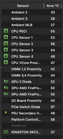

I am noticing that DIMM 3,4 Proximity temperature is much above DIMM 1,2 Proximity temperature:
DIMM 1,2 Proximity - 43°C stable
DIMM 3,4 Proximity - 57°C to 76°C constantly changing up and down.
Any ideas if this is an indication of an issue and if yes, what may the issue be?
How is DIMM 3,4 Proximity temperature in yours?

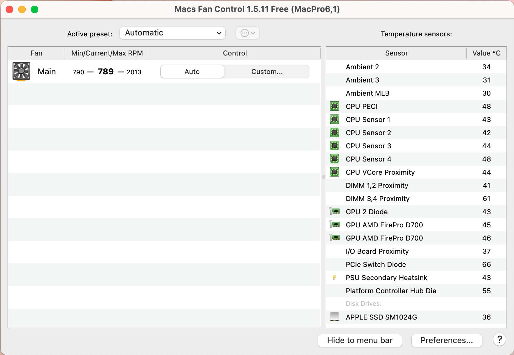

Yes, I am using Macs Fan Control, that is how I noticed the temperatures:
Here on the screenshot DIMM 3,4 Proximity is at 61°C, but it varies constantly, while DIMM 1,2 Proximity is at 41°C and does not fluctuate.

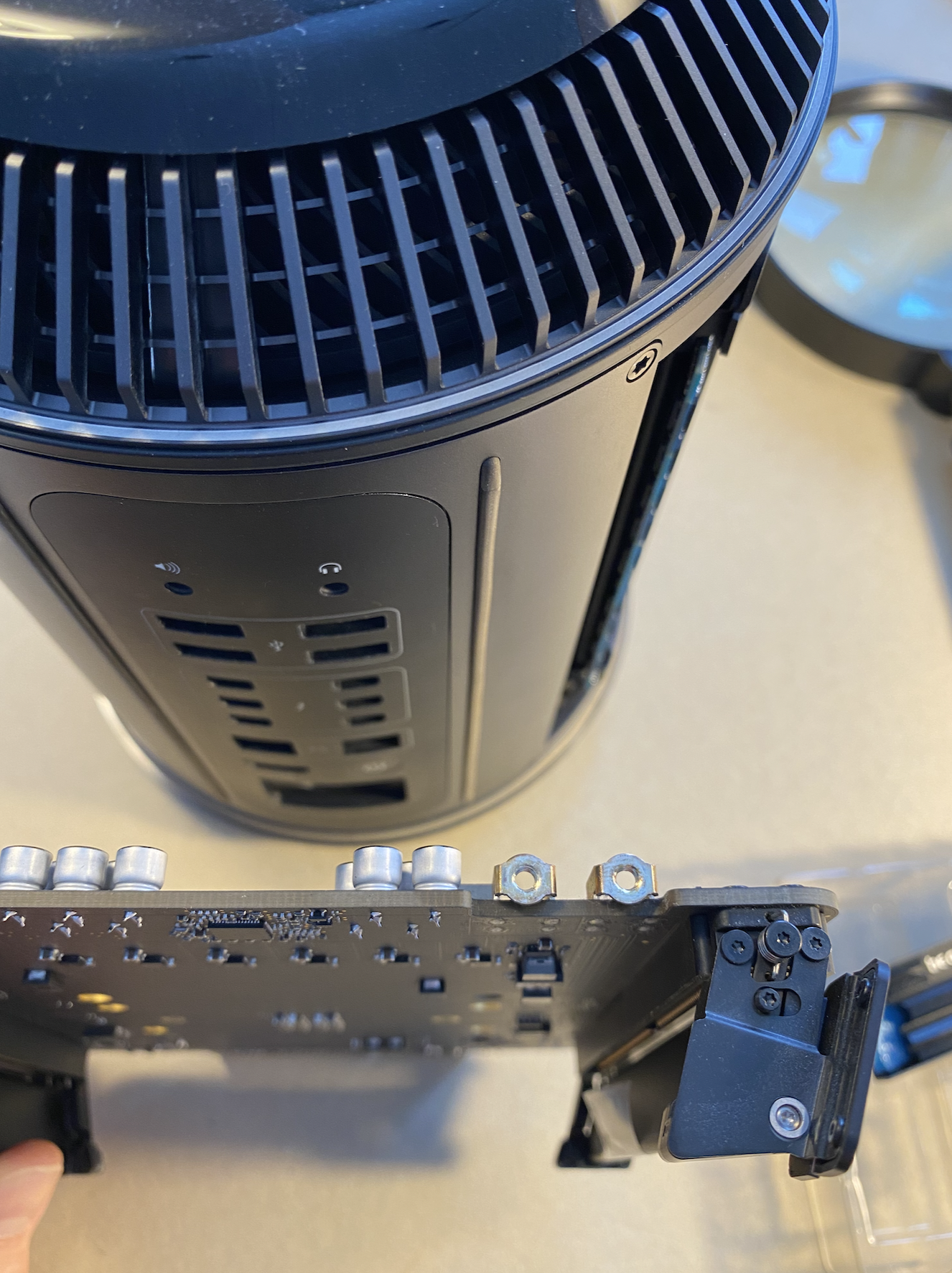

Took out my spare motherboard. I still can't locate any sensors.
But Dans version on iFixit sounds something worth checking I think.
Those bus bars do locate on DIMM 3,4 side. Connectors and DIMM 3,4 are on the right side of the board looking from the back of the Mac. Blade SSD is on the left side GPU (looking from the back again).
Maybe a slight chance of a dust ball in the wrong place. If so, some compressed air might help, but might need disassembling it too to be sure.

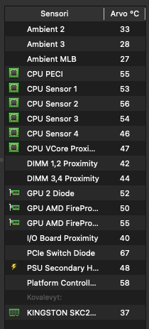

There is PLX pex2723 switch on the right side too. But I doubt it would leak that much temp to the other side of the board. Your PCIe switch diode seems normal, at least comparing to my tCMPs that is (66°C).
PLX is on the upper left in the pic. assembly is upside down, so you have to think about the final location of things.
Of course there is PSU too in there on the back of the board, but that reads 43°C in your pic, so it's not that hot either is it.

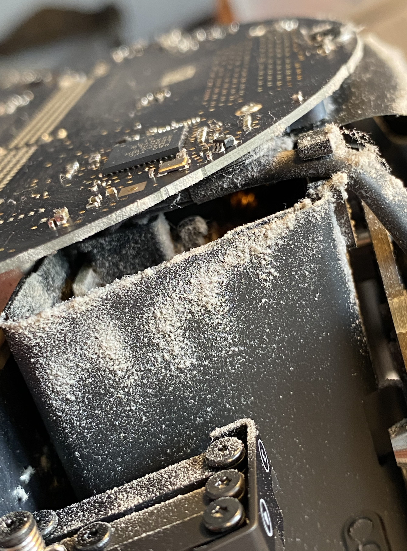

edit. totally agree with @m4v3r1ck. Dust is an enemy. And you don't want to let it live in there in your computer. Please look at my D300, beginning the disassembly. It's the DIMM 3,4 area, PSU just behind DIMM sockets.
Reactions: m4v3r1ck

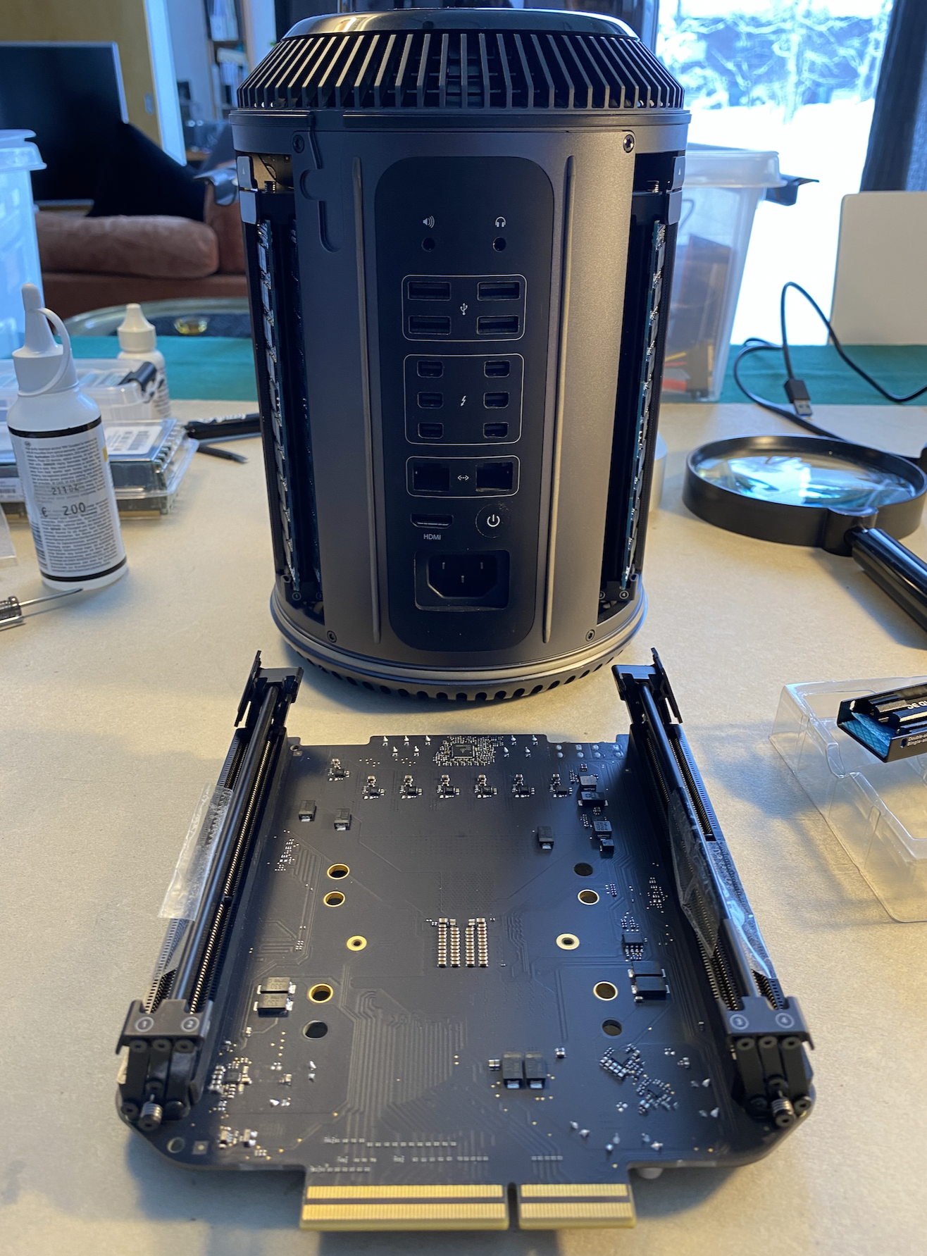

@mikas - I am thinking of examining closely the CPU riser card, but I did assemble my MP already. If you still have your spare motherboard, will you please share some close up pics of front and back with maximum resolution? Perhaps split each side in two pics to show each half. Thanks in advance!
^ That document has been really of great help. I probably wouldn't have dared to proceed with my 6,1 teardown and maintenance without that. But that + iFixit and you're good to go.
My pics from yesterday if needed:
tcMP_cpuboard_full_size_png
I can take some more close-ups today if needed.
Reactions: m4v3r1ck
