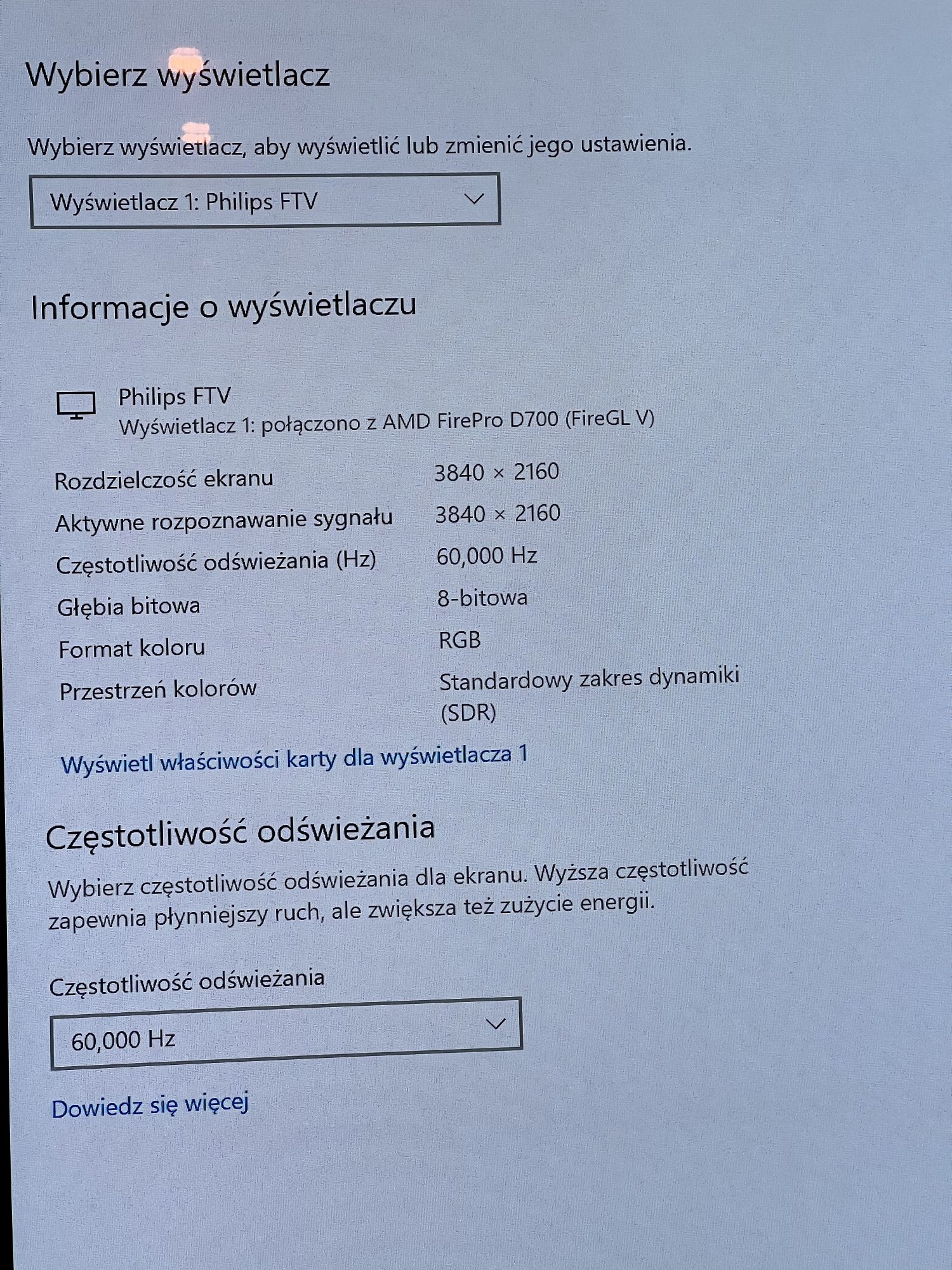

Mac Pro connected with mDP cable to HDMI 2.0. Windows 10 (Bootcamp) shows 4K@60 perfectly. MacOS Monterey shows only 4K@30Hz.
Did anyone have a similar problem?
Which cable are you using? Is it an active one?
Did you check in Windows that it is actually 4K@60 RGB and not just YCbCr?

Display settings in Windows 10 4K@60Hz - Cable mini DisplayPort - HDMI 2.0
Yeah, you clearly stated your connection and the screenshot shows that everything is set up correctly and works as intended on Windows.
Sorry, no idea then what the problem is with Monterey.
