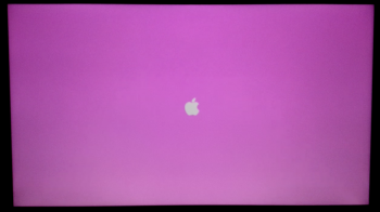

Hi,
When I start my Mac Pro (2013), first screen with apple logo is pink (see attached screen). I've tried Reset NVRAM but without success. Any ideas?
I made decision the re-install Sierra OS. So, initial screen with apple logo is pink as usual and after then installer is starting up, it's changing to the "normal" colors ?!?
Maybe I ask stupid questions:
- do I need to reset SMC (reset PRAM I did already), if so - how to do it on Mac Pro 6.1 (late 2013)
- am I able to change display settings for initial screen (PAL/NTSC etc)
Please note I'm using HDMI port (several cables already checked and two different monitors)
Thanks for any help

[doublepost=1479942513][/doublepost]I've plugged my Mac via Thundebold cable to TB Display and everything looks normal.....
It seems that only HDMI output is impacted by this problem
That is some good news I guess, I personally don't have a thunderbolt display and rely on the HDMI connection of the Mac Pro to my external Asus monitor. I have tried a thunderbolt to HDMI adaptor going from the Mac Pro to the HDMI input on my monitor but the issue with the startup screen is still there.
I believe you may be right that this is a HDMI issue, I have read a few other threads on here including other users who are having difficulty with HDMI displaying the correct resolutions since upgrading to macOS Sierra.

I also have the Mac Pro MD878B/A (Late 2013), did you manage to solve this issue? I updated to the 10.12.2 Beta 6 a few hours ago hoping that it would solve it but the issue is still there.
Also, I have noticed that when booting into internet recovery the startup screen becomes green instead. I'm really worried that this is a hardware issue and only have a few months of AppleCare remaining on my Mac Pro. Can anyone offer any advice?

The fact that the issue is still present when reverting to a previous version of OS X has me thinking that it's a hardware issue.
Yes, it's most likely a hardware issue as you've discovered by rolling back to previous versions
and on the fact that there is an Apple repair program for that video card issue.

I have absolutly same issue on my second monitor which connected via hdmi. I think it happen because kernel outputs wrong signal type to monitor. When the OS start it converts signal from yuv to regular rgb.
I had the same problem with my 2013 Mac Pro..Tech guy said it was the 2nd video card going out.
Since there was a "silent" repair program they put in a new one for no cost.

You mean that problem gone after Video Card has been replaced by Apple support? If so, how long they kept your computer?
I took it to an authorized reseller/repair place.
Turnaround for replacing it was maybe 2 days.
