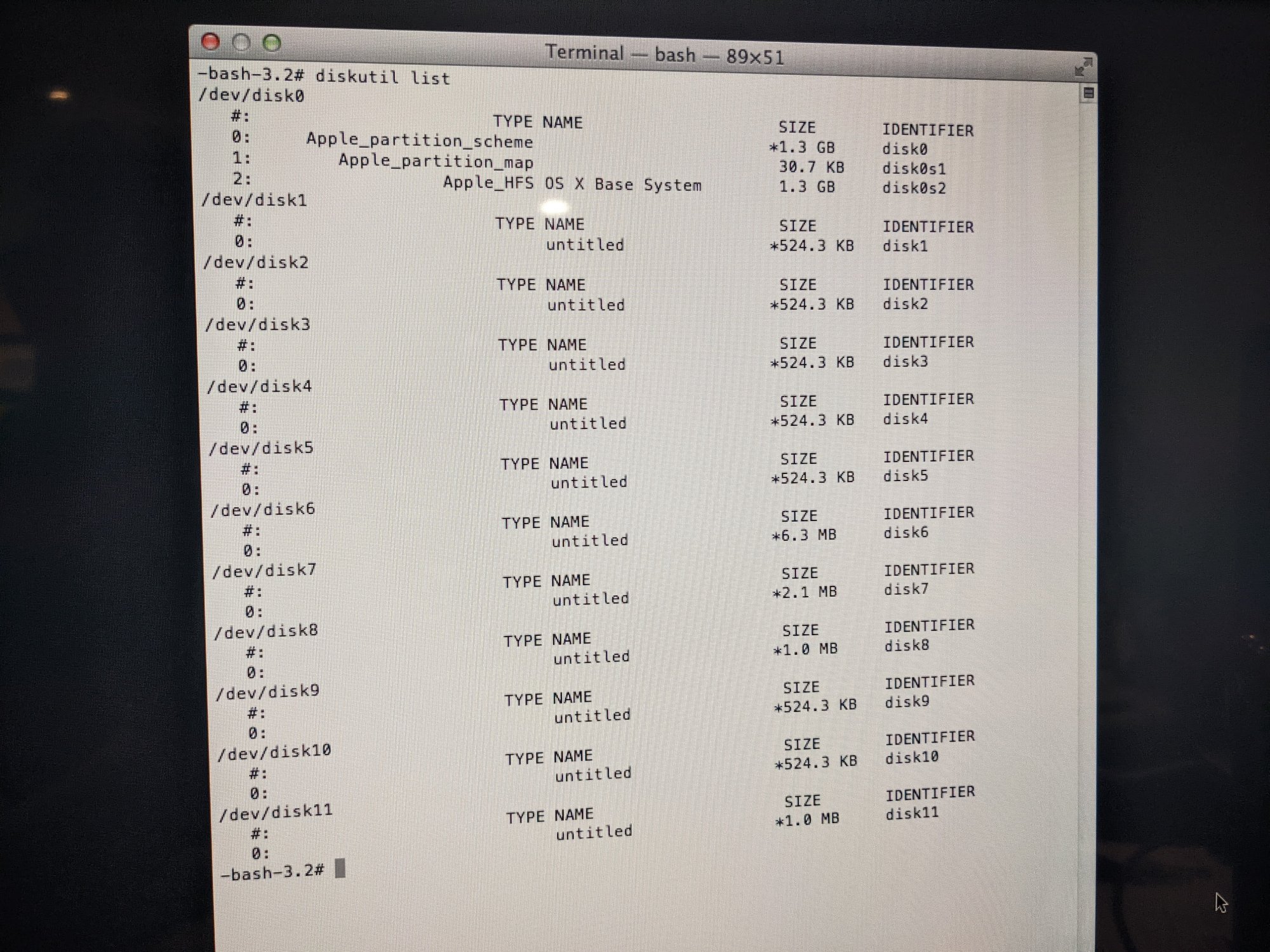

Thanks TSIALEX, I'm only seeing the 1.3 GB Apple_partition_scheme. I'm not seeing the 970 EVO.

Right, your 970EVO is not being detected at all, maybe the 12+16 adapter is not correctly connected?

Still not showing anything. That 1.3 GB Apple_partition_scheme must be on the SSD, right? I don't see that anywhere else.

Nope, it's a RAMDISK created to download and temporarily store/run the Internet Recovery (OS X Base System).
