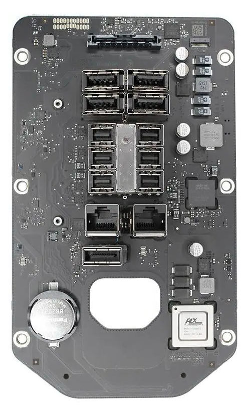

Are you in position to swap I/O boards ?

So, you have cleard NVRAM, reset the SMC, swapped PSU, I/O board nad Logic Board, and its still the same problem ?
You could try with different, 100% good RAM modules before going to CPU board and after that I'm out of ideas. There is no reason to suspect on GPUs or NVMe with those symptoms.

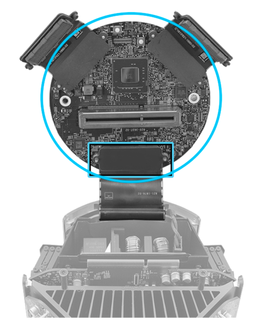

So really the issue can only be with the CPU board. But why should that break all of a sudden?
Hi, I am on the same boat. Exactly the same symptons and I have tried everthing too: swapped PSU, I/O board, CPU, memory, etc. even changed the BR2032 battery for a new one... the only thing I haven't swapped is the circle logic board and the CPU riser card (the one that contains the CPU itself and the RAM slots) so I guess the problem must be in one of these cards but how should I know for sure which is the faulty one? It doesn't make sense that a computer doesn't turn on (well sometimes it does turn on, sometimes takes several minutes to turn on and in most cases it doesn't do anything at all so looks like random pattern) due to any of these two boards I haven't swapped, right? or are they?
