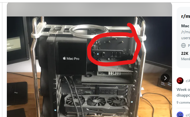

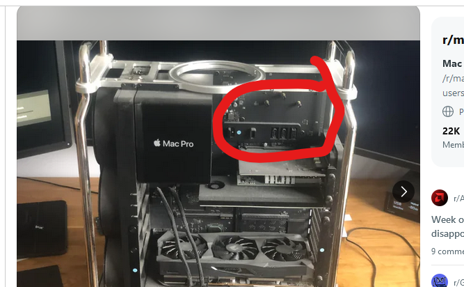

This user seems to have one working and in their photo, it doesn’t have an ssd module in it:
You are mistaken, NAND modules are located on the backside of the logic board:
Just one NAND module instaled, second slot empty.

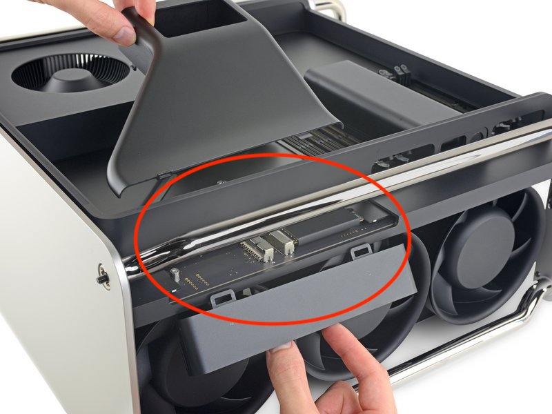

AH! This is not what I was talking about! I was talking about the Storage module that sits on the front!
Useless in your case, like I said multiple times here, you need at least one NAND 1 module present and correctly configured for the Mac Pro to power on.
I never said the NAND modules are missing though. I said the Storage Module on the front is missing.

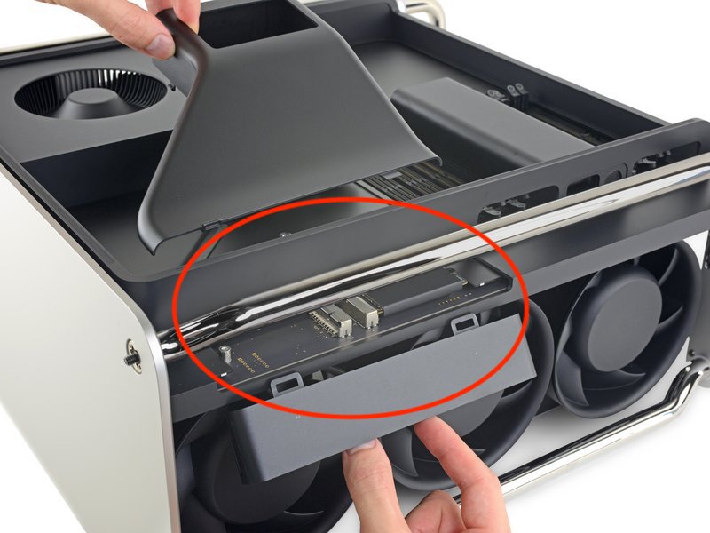

Here:
I was under the impression that there should be some form of module here for SSDs etc.
Oh, you meant at the back, inside? And were referring to an empty area that a couple of third-parties have made drive brackets for? OK.
