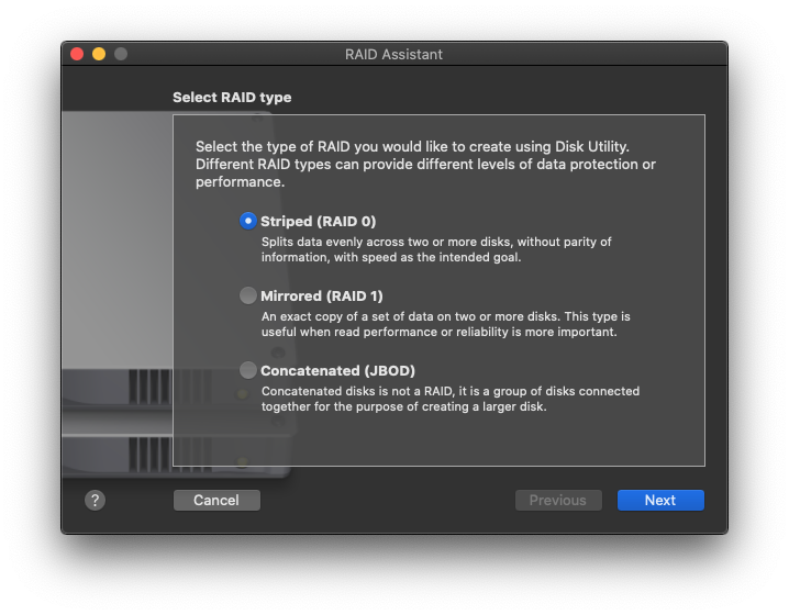

Thank you. Much appreciated. What I want is a 20TB internal hard disc. Can I set up the Pegasus enclosure with an 8TB and a 12TB drive so that the two disks show up as a single 20TB disk?
Last I checked, Apple's Disk Utility supported JBOD. That should allow you to concatenate the 8TB and 12TB drives together into a 20TB volume. But you won't have any redundancy with it at all.

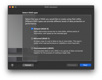

Yes.... Use Disk Utility option 3 in the attached screen shot....

Redundancy uses RAID-1 to keep a copy of each file on each disk - if one disk fails, all the files are safe on the surviving disk.
Consider getting two 12 TB disks - then you can stripe them (RAID-0) for better performance with large transfers.
