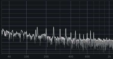

It doesn't seem like a ground loop to me. As I understand it, the speaker is not amplifying a 50-60Hz hum, but it's transformer is physically producing the noise.
The original post is a little vague ("After turning on the Mac, the transformers in each studio device start working louder. On the recording, of course, the microphone stands very close to the housing with the transformer but this humming is heard in the place where I am sitting."—the first sentence sound like electrical hum, the second physical), but in later posts he seems to be clear it's electrical.
It's definitely 50 Hz, you can see the harmonics...
