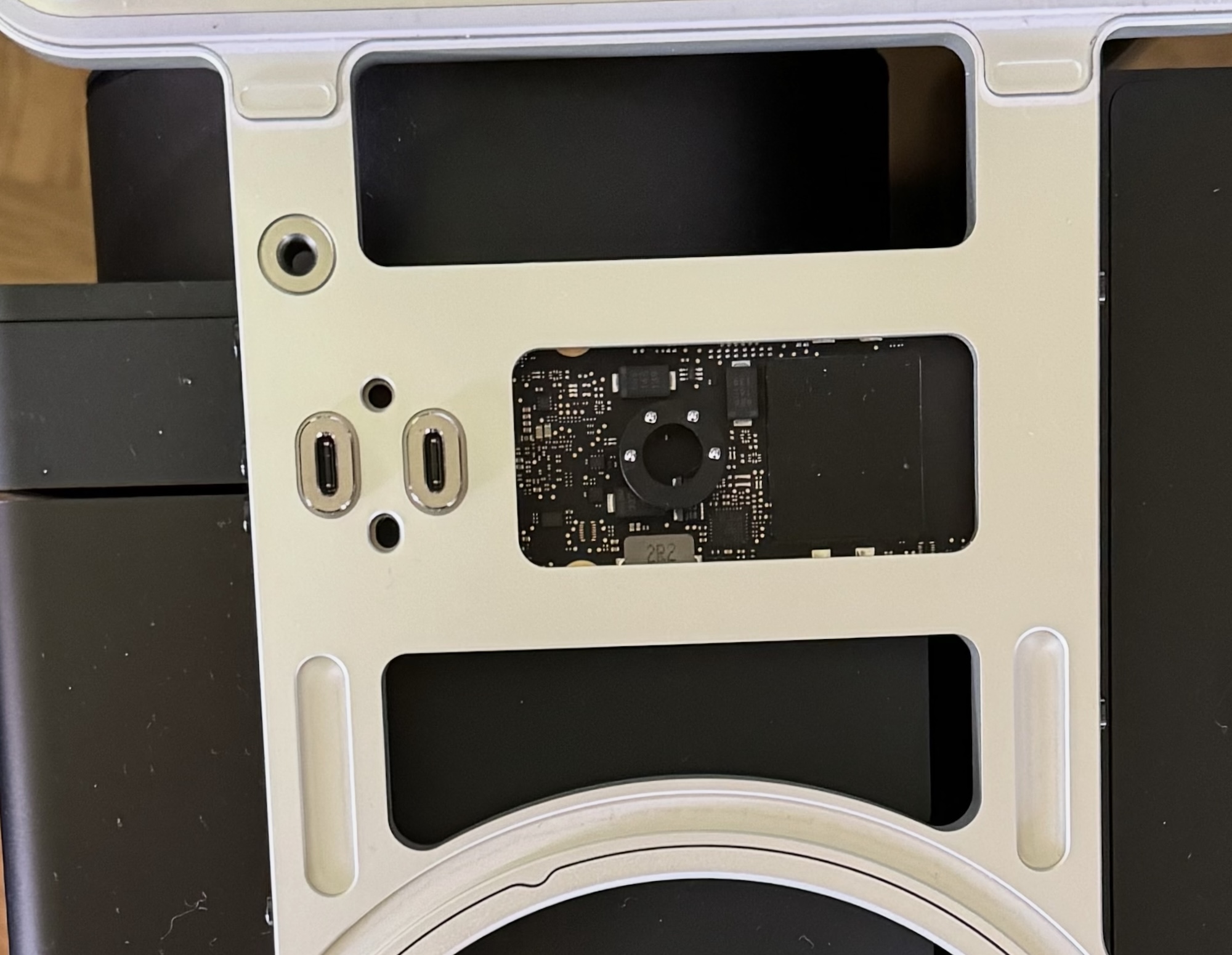

I watched a full teardown of the desktop version, a couple of years ago. But I did not pay attention to any details concerning the electrical connections to the power button, two Thunderbolt ports, and the lock.
All located above the CPU.
Trying to inspect it without a teardown. I would guess the small card slots into the motherboard, without any ribbon cable.
I suppose it is just as difficult to see how it is connected on the rack version.

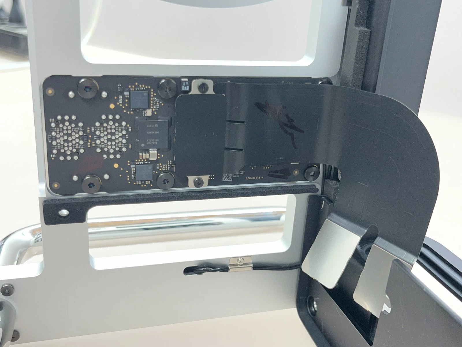

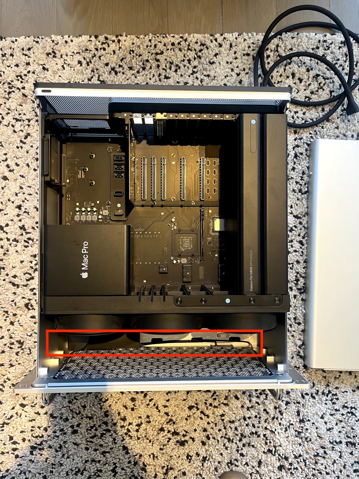

Yes, that was my initial concern and I noticed on the rack model that a flat cable runs from the CPU side to the front of the case.
So my thought is I can replace it with the connector on the top case of the desktop version.
Since both versions have two connectors on the CPU side of their motherboards for this flat cable.

It does indeed look like it should be connected in the manner you suggest.
Great photos 👍 First time I see the cable running along the fan rack.

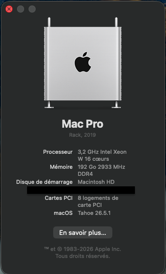

So I just swapped the case from a rack Mac Pro to a desktop Mac Pro.
There is some difference between those two versions, but as long as you have the equivalent part for one or the other, it should work.
Even the logo of the Mac in the information tab changes for the desktop.
but as you can see, it still mark as "RACK".
