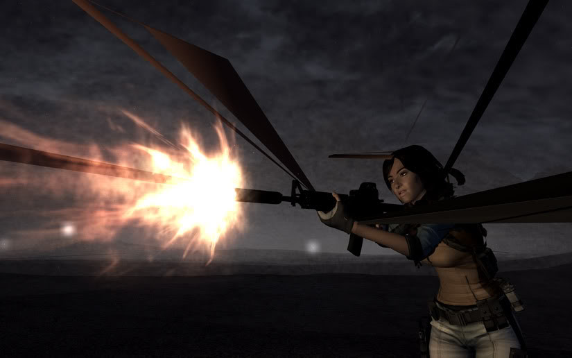

Booted into Windows 7 64-bit. Installed the drivers, everything looks great. Fire up Fallout: New Vegas, crank everything up to Ultra. Looks amazing! Great framerate, too.
For about 2 minutes, then I start getting an unbelievable about of stretching polygon artifacts, random snowy pixels, etc. etc. Quit the game and open Catalyst, which informs me that the GPU is at 61 degrees celsius, and the fans at about 27%. No where near too high for the card.
My question is, where is the issue? Faulty card? Do I need to manually set the fans on the card higher (Which would be idiotic... why include the auto fan settings if they're incapable of working)? Is it a driver issue? I realize F:NV isn't the best coded game out there, but I did not expect this.

Got a new card today and installed it. Downloading Starcraft II just to test something on the OS X side, before I reboot into W7 to try games there. Fingers crossed that a new card is the solution. Will update.
Also, I watched temps yesterday, and let the games run with the artifacts going nuts, and temperatures still hovered at 65C plus/minus 3 degrees. Completely within normal range.
Update!!
quick update: Got a replacement card from Apple, and so far it's functioning flawlessly. This one is exactly what I'm expecting. Not sure what the issue was with the other card, but it was definitely faulty.
