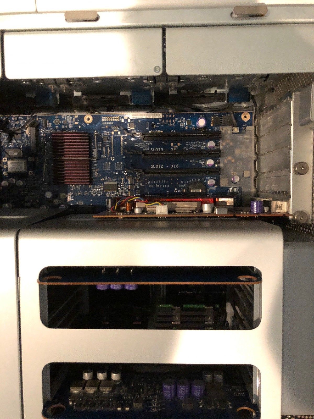

MP arrived, total basket case, parts just tossed in.
It was the dual CPU model, so there is that, tho the tops of the CPU's are so burnt I can't figure what they are.
The logic board needs replaced, as not only is the battery clip broken off, but the power connector for the front fans is broken on the logic board, looks like from the seller just jamming the fan cage in all side wise before shipping.
System does power on, so I'm pretty sure the PSU is good, but no boot chime and the CPU's never get warm. The OT A and OT B diagnostic LEDs seem to stay on.
Maybe fried logic board and CPU's.
The hard part will be tracking down the missing 12 logic board screws, but at least they left me two of them, so maybe a tip to the HW store.
Anyone got a spare MP3,1 logic board they want to part with?

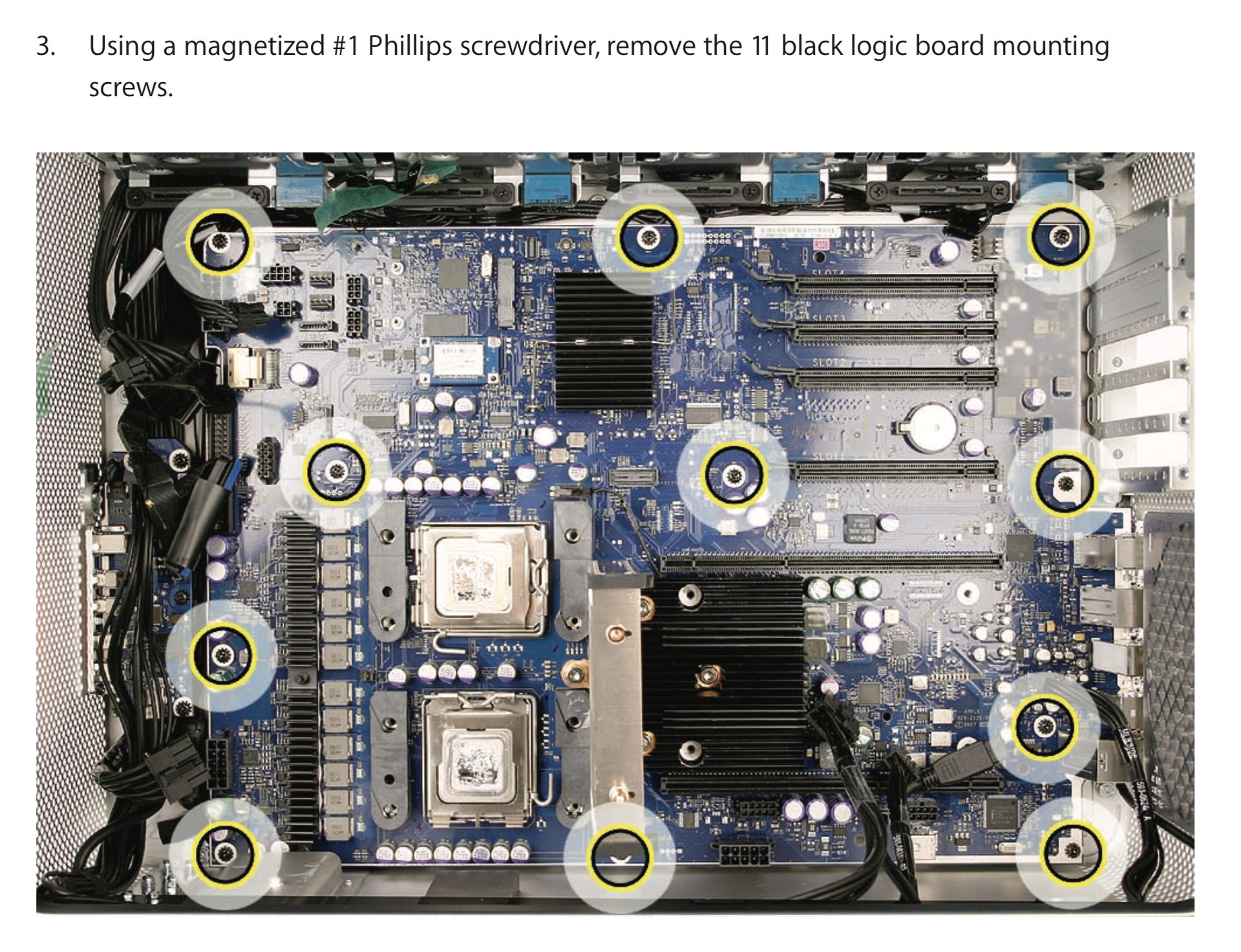

For your info, The Apple "Service Source" for 2008 Mac Pro says only 11 mounting screws for the logic board.

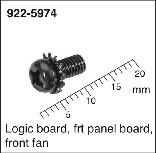

And this is the spec (M3.5x7.5mm)
