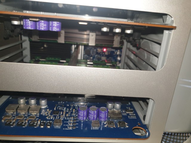

You mentioned there were lights blinking on the board. Where are they and what labels are beside the blinking LED? If it's the RAM slots, this could all be related to that.

Yess it is the red LED for the RAM slots. They go red when I turn on, then go out.
In between them on the motherboard there is a red LED that stays on.

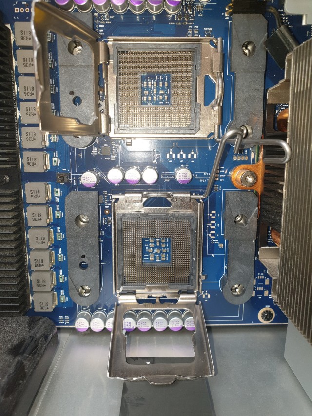

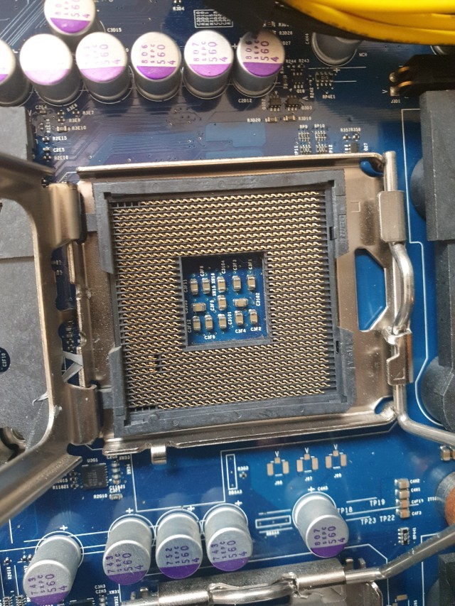

But doesnt this socket look damaged? Like three pins are bent the wrong way?
Perhaps I damaged them when I was changing out the cooling paste.
Will it boot with just one CPU in place?

Yes, it's damaged and it's the primary CPU, where you install the Xeon when you have just one.
You can repair it if it's only bent, I did it more times than I like to admit. There are threads about it, like this one Mac pro 2009 CPU Socket damage.
