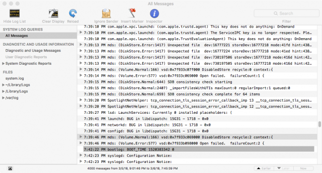

I was trying to extract the High Sierra image I had and it crashed again. Black screen, high fans, on El Capitan and the 8800GT.
Got this from the console though right before it shut off not sure if this is of any help...
