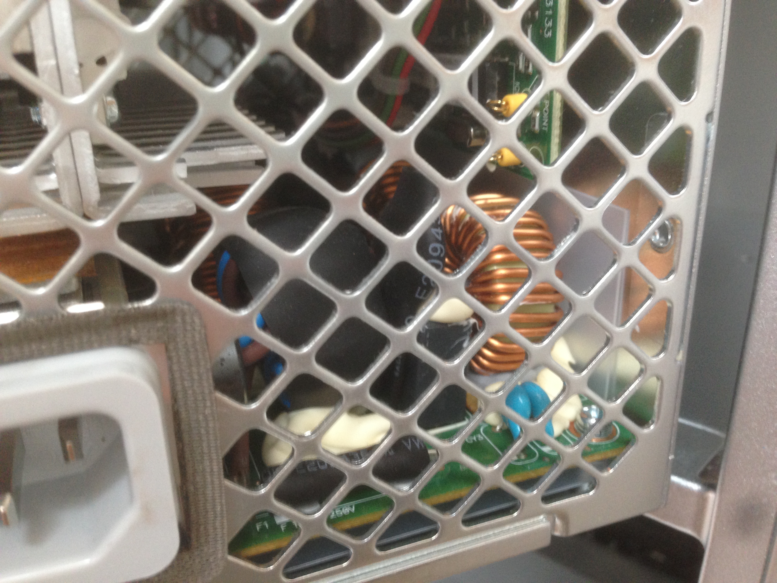

1. PSU seems good - but when I looked inside there was some kind of blue leaky stuff coming out of some adjustable potentiometers type things at one end of the board - like rigid bubbles - and also white gunk in-between some of the capacitors - is this normal for this PSU - or is this the dreaded leaking capacitors issue? (I will strip down again and snap some pics if this seems likely). The trickle led is ok when I check and it does power up using a CD as described above. wierd

White gunk on capacitors is bad - as in shot. My first guess is PSU, 2nd guess would be video card. If it's just powering off with no warning I think it's safe to assume it's a hardware issue.

I looked at the PSU from the other machine (2010 Mac Pro 2.66 Quad) and it looks the same as mine did - with some kind of paste in and around some of the components? - must be normal? I'll add some pictures of this later

Heres a picture of a 2010 Mac Pro PSU - note the 'paste' around several components - same as my PSU in the 3,1 MP.

To answer your questions concerning the PSU, the white goop between the capacitors are there to stabilize them during moves as well as cut down on vibration/noise during use. The blue goop you see on the potentiometers is kinda like loctite for them if not applied over the years thermal expansion & contraction as well as vibration will start to change the configuration which depending on what they do and which way they turn tends to raise or lower voltages in the PSU. In short its normal and necessary for a quality PSU.
