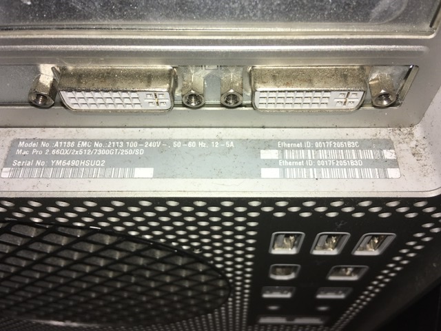

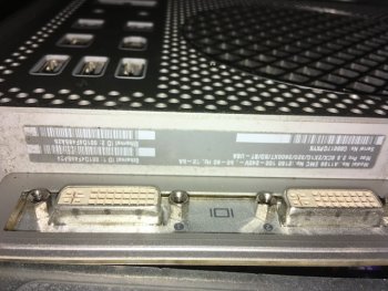

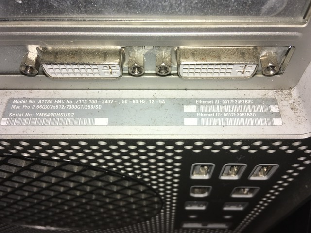

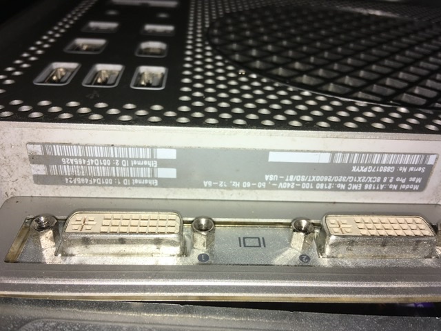

Hi everyone! I just acquired 2 Mac Pros that I was convinced were G5’s. I was over in the PowerPC section, and the fabulously helpful pros over there helped me figure out that I actually have 2 Mac Pros.
Soooo... yeah... I have a 1,1 & and a 3,1.
Both have DVI display ports, and I do not have a DVI monitor to test them on.
What decent, but cheap video card can I get to test these on?
Thanks in advance.
