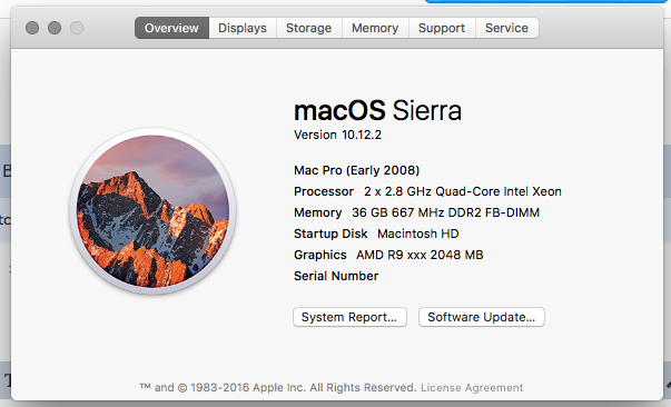

Success! (after too many futile attempts)
In order to install Sierra on my Mac Pro 3,1 (early 2008) I had to both use an original 2600 XT graphics card, and install from an internal drive (found 16GB for a partition on the drive I use for backup/timemachine). Flash-drive didn't work and other graphics cards - flashed 5770, GeForce GT120, Radeon RX 460, each prevented the installer from booting.
And Foxlet's thing-a-majig allowed it to update to 10.12.2 - kudos and to dosdude1 and LarrikinAus
and vivo's instructions were a great help. Many many thanks!!!
Everything so far is now working better than ever !!!
(although quite curiously the RX 460 (which only shows up as R9 xxx 2048 gets fastest and highest scores with the 2600 XT also installed - but not connected to my monitor - and if I do connect both, then App Menu's don't appear correctly in the menu bar) ??? )

Eventually it worked on my 3,1 (SIP disabled and BCM94360CD wifi+bt card installed).
At first I couldn't create a bootable usb installer. My MBPr (2013/Mojave) kept complaining that the target volume (a USB-attached 2,5" drive) wasn't "a valid mount point". The solution here helped me edit the installer version number in the relevant info.plist. Then I could create a bootable installer using the createinstallmedia command.
I booted the Mac Pro in target disk mode and rebooted my MBP from the installer volume. Then I selected the Mac Pro target disk and installed away. It went well, though it seemed possibly to go a little bit slower than I'm used to, likely due to the USB2+thunderbolt+firewire connection.
I then rebooted the MBP from its normal boot volume and added my board ID and computer spec to PlatformSupport.plist. I encountered no permissions problem but could save the file.
Then I booted into Sierra and it seems to work like a charm.
