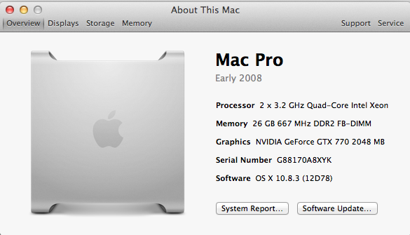

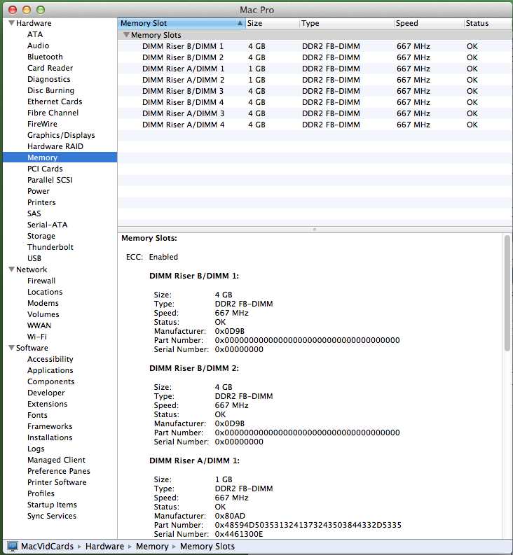

I did the 3.2 update on our 2008 testing machine.
Was about 150% easier than putting 5680s in 2009.
One tricky part is there is 1 additional screw that wasn't in 2006/7 machines holding front fan in.
I think the Xlr8 article mentions it.
Anyhow, the fact that Apple DIDN'T use top CPU option means that PC folk bid up the highest one and leave the 3.2s to go for cheap.
I tried to get 800Mhz memory but as 666 mentions, it's much harder to find and much more $$ so I have some 667 in there, which means they are all clocked down.
In a perfect world I would find 800 Mhz sticks in 16GB size, but that isn't going to happen.
