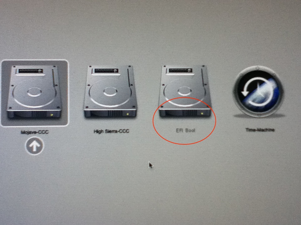

And it never will, but you should see something called "EFI Boot", click on that and tell us what happens.

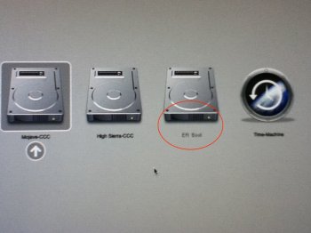

This is how my MP3,1 Boot screens shows up, the marked drive boots Mojave on my APFS Accelsior SSD.
It's only this way on unsupported systems BTW.
