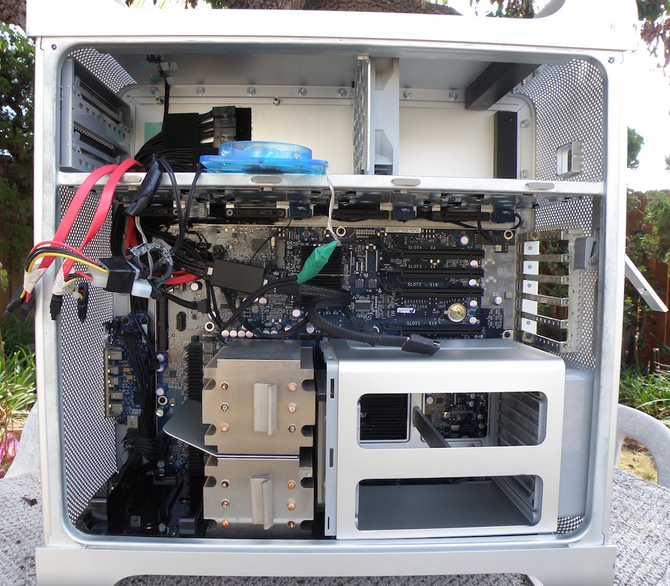

What I must do soon is, despite a quick attack with the vacuum cleaner, strip it and clean it up properly, it desperately needs it...
"Strip it and clean it up properly"
If not done properly you will not be allowed in the 3,1 club! 😂
